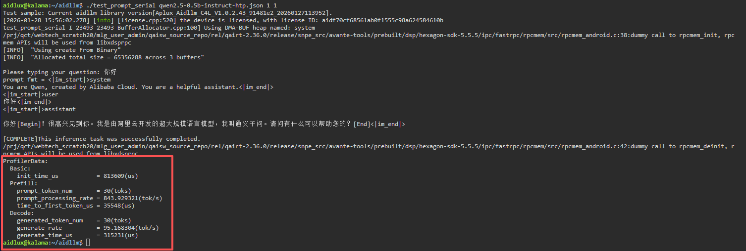

mv qnn229_qcs8550_cl2048/* /home/aidlux/aidllm/Model Performance Monitoring
💡Note
Please ensure that the sample application can be executed successfully in its entirety.
Taking the example Deploying Qwen2.5-0.5B-Instruct on Qualcomm QCS8550
# Install dependencies
sudo apt install libfmt-dev
# Compile
mkdir build && cd build
cmake .. && make
mv test_prompt_serial /home/aidlux/aidllm/
# Run after successful compilation
# The first parameter `1` enables profiler statistics
# The second parameter `1` specifies the number of inference iterations
cd /home/aidlux/aidllm/
./test_prompt_serial qwen2.5-0.5b-instruct-htp.json 1 1- After entering the conversation content in the terminal, you will see the following log information:

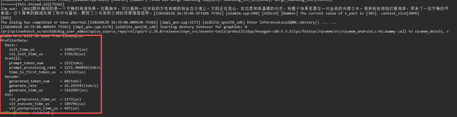

├── window_attention_mask.rawModel Performance Monitoring
💡Note
Taking the example Deploying Qwen2.5-VL-3B-Instruct (392x392) on Qualcomm QCS8550
sudo apt-get install libfmt-dev nlohmann-json3-dev
cmake .. && make
mv test_qwen25vl /home/aidlux/aidmlm/
cd /home/aidlux/aidmlm/
./test_qwen25vl "qwen25vl3b392" "config3b_392.json" "demo.jpg" "Please describe the scene in the picture" 1- After entering the conversation content in the terminal, you will see the following log information:
