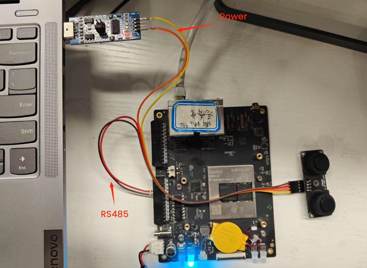

11.Robot Peripheral Kit Test
At present, the Rhino Pi A1 has passed internal tests for the following robot peripheral kits. However, the actual supported kits are not limited to those listed in the table below, and there are more kits waiting for you to explore.
NO.Device TypeDevice Name
1USB to Serial Port DeviceUSB TO 4CH TTL
USB TO 8CH TTL
CH9102
CP2102
2Depth CameraIntel RealSense D415
3LiDARLaser LDS-50C-E
4Audio KitAISPEECH
bothlent Power Amplifier Board
HSY 1.5-inch Full-range Speaker with Sound Cavity
5Ultrasonic SensorDYP-A02YY-V2.0 (without shell)
9TOF SensorNooploop TOFSense Series
10Temperature and Humidity SensorSM7820B

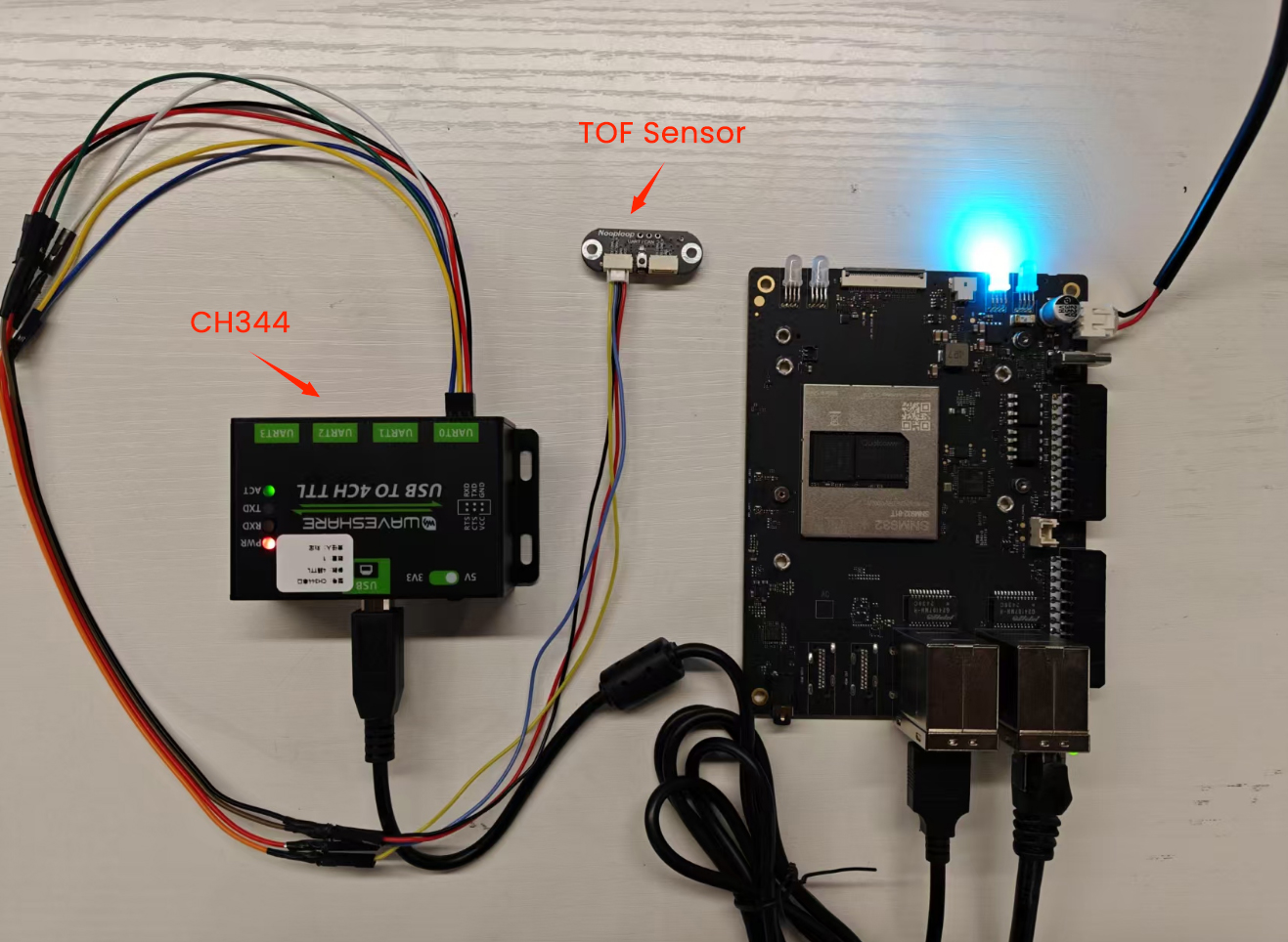

11.1 USB TO 4CH TTL
11.1.1 Preparation
  • Rhino Pi A1
  • USB TO 4CH TTL serial port device
  • CH340 USB TO TTL test board
  • Several Dupont wires
  • Windows computer
11.1.2 Hardware Connection
  • The development board is connected to the CH344 device via a USB interface.
  • The CH340 test board connects the USB port of a Windows computer and the CH344 device.
Among them: The RXD, TXD, and GND of CH344 are connected to the TXD, RXD, and GND of CH340 respectively.
11.1.3 Testing
💡Note
When executing commands in the terminal on the AidLux desktop, if you need to enter the aidlux password, please input: aidlux
  • After obtaining the IP address of the Agix development board, log in to the AidLux Web desktop through a browser. For specific login methods, please refer to the hardware guide Login Chapter.
  • After logging in, enter the following command in the AidLux terminal to check whether the CH344 serial port device has been recognized.
ls -l /dev/ttyC*
💡Note
The device names of the CH344 multi-channel serial port correspond one-to-one with the actual physical UART interface names, that is: /dev/ttyCH343USB0 corresponds to device UART0; /dev/ttyCH343USB1 corresponds to device UART1. 以此类推。
  • Use the stty tool in the AidLux terminal to configure the device's UART port.
stty -F /dev/ttyCH343USB0 115200   # Set the baud rate of ttyCH343USB0 to 115200.
stty -F /dev/ttyCH343USB0 -isig -icanon iexten -echo
  • Open the "Serial Port Debugging Tool" on the Windows computer, and open the corresponding serial port and set the baud rate (keep it consistent with the setting in the AidLux terminal).
  • After setting up both the "Serial Port Debugging Tool" on the Windows computer side and the terminal on the AidLux side, you can perform the test of sending and receiving information.
  • AidLux side information reception test
Execute the command in the AidLux terminal to check the received messages.
sudo cat /dev/ttyCH343USB0
Send a message using the "Serial Port Debugging Tool" on the Windows computer, and at the same time, you can check whether the message can be received on AidLux.
  • AidLux side information sending test:
Execute commands on the AidLux terminal to send information, and at the same time, you can check whether the information can be received on the "Serial Port Debugging Tool".
echo 123abc > /dev/ttyCH343USB0
💡Note
If you are prompted that you have no permission, please execute the command: "sudo su" to switch to the root user before testing. You need to enter the password: aidlux

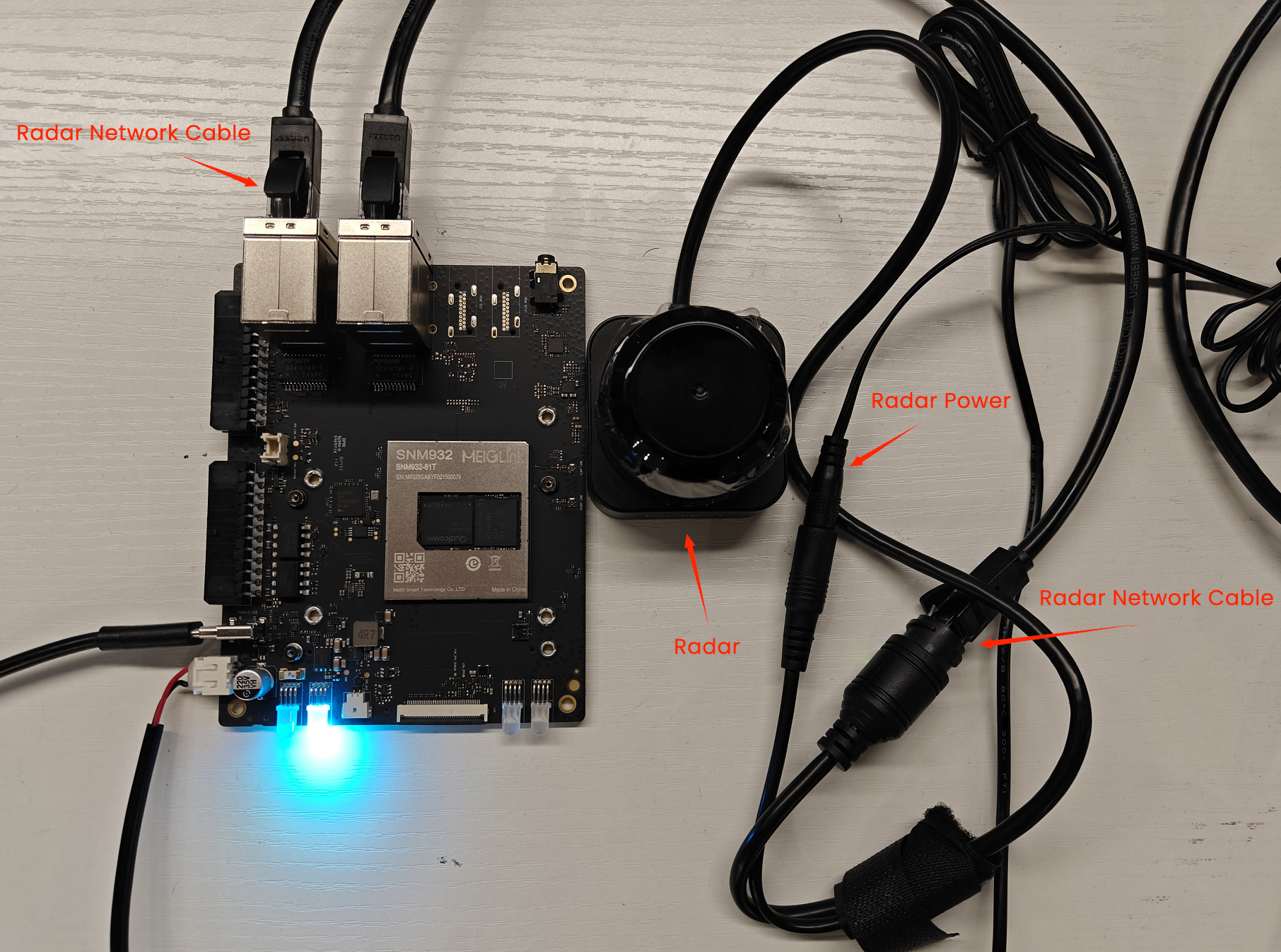

11.6 Laser LDS-50C-E Lanhai LiDAR
11.6.1 Preparation
  • Rhino Pi A1
  • Preinstall Ubuntu Desktop, ROS 2, and RViz 2 on AidLux-Ubuntu 22.04
The specific installation method can refer to Robot Software Installation Guide
  • Laser LDS-50C-E (Lanhai Laser Radar)
  • 12V Power Supply for the Radar
11.6.2 Hardware Connection and Network Configuration
Connect the radar to a 12V power supply, connect the Ethernet port to any Ethernet port of the Rhino Pi A1, and configure the default IP (you can use the ifconfig command to configure a temporary IP).
A standard Ethernet cable is used to connect the LDS-50C-E and the Rhino Pi A1 via their standard Ethernet interfaces. To ensure normal communication between the radar and the Rhino Pi A1, they need to be on the same network segment. The factory settings of the radar are as follows:
  • Radar IP: 192.168.158.98
  • Radar Subnet Mask: 255.255.255.0
  • Radar Gateway: 192.168.158.1
  • Radar Default Upload Address: 192.168.158.15
The network settings of Rhino Pi are as follows:
  • Ethernet Port IP: 192.168.158.15
  • Ethernet Port Subnet Mask: 255.255.255.0
  • Ethernet Port Gateway: 192.168.158.1
After connecting the Ethernet cable and configuring the IP address, check if the network is connected using the Ping command.

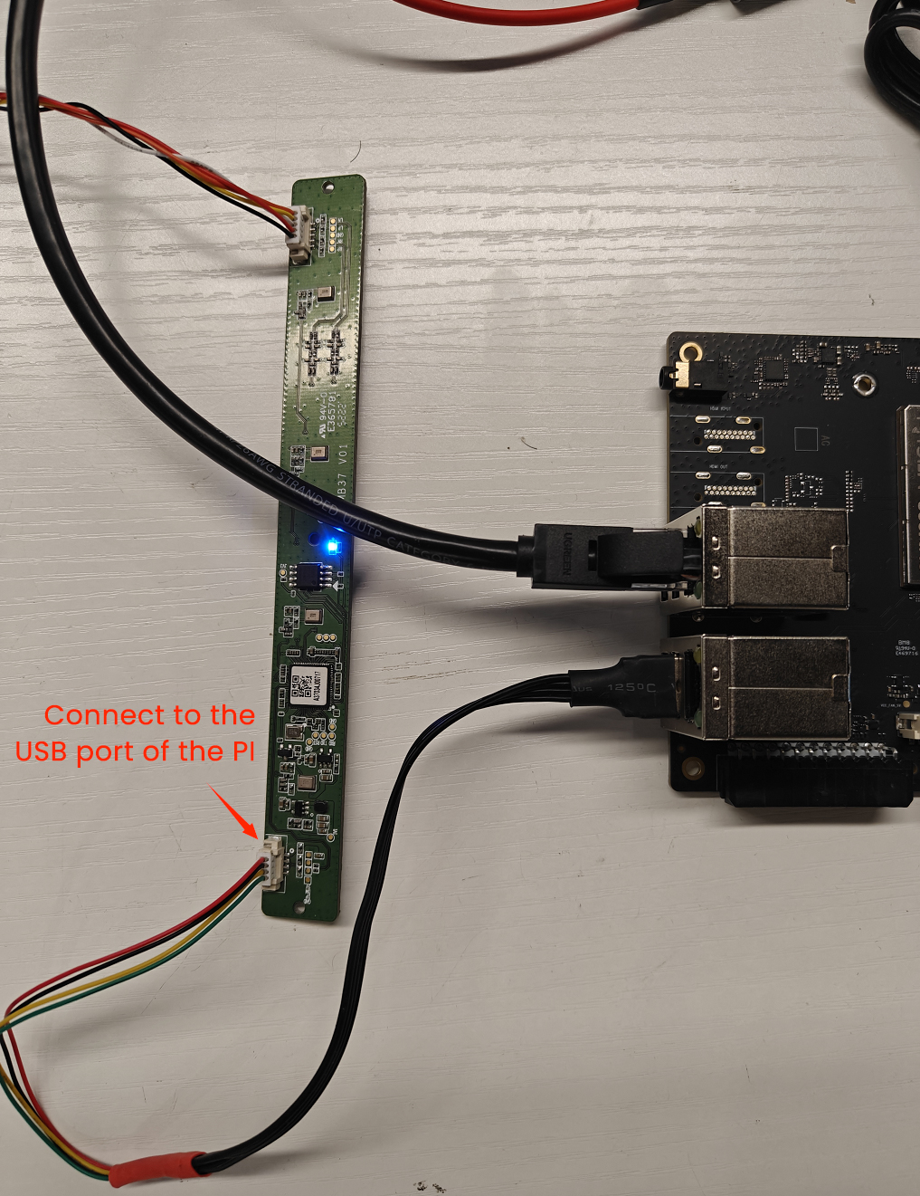

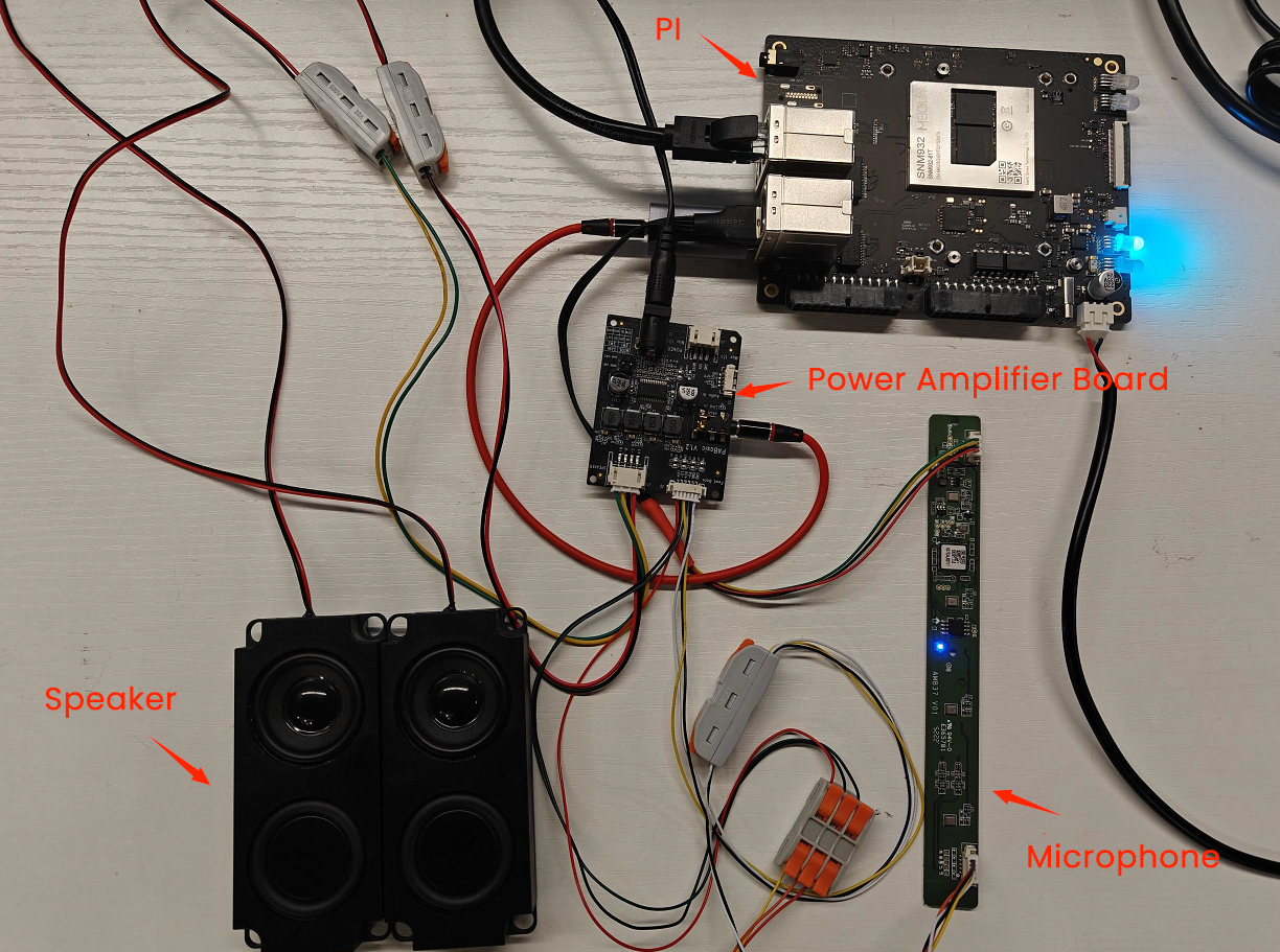

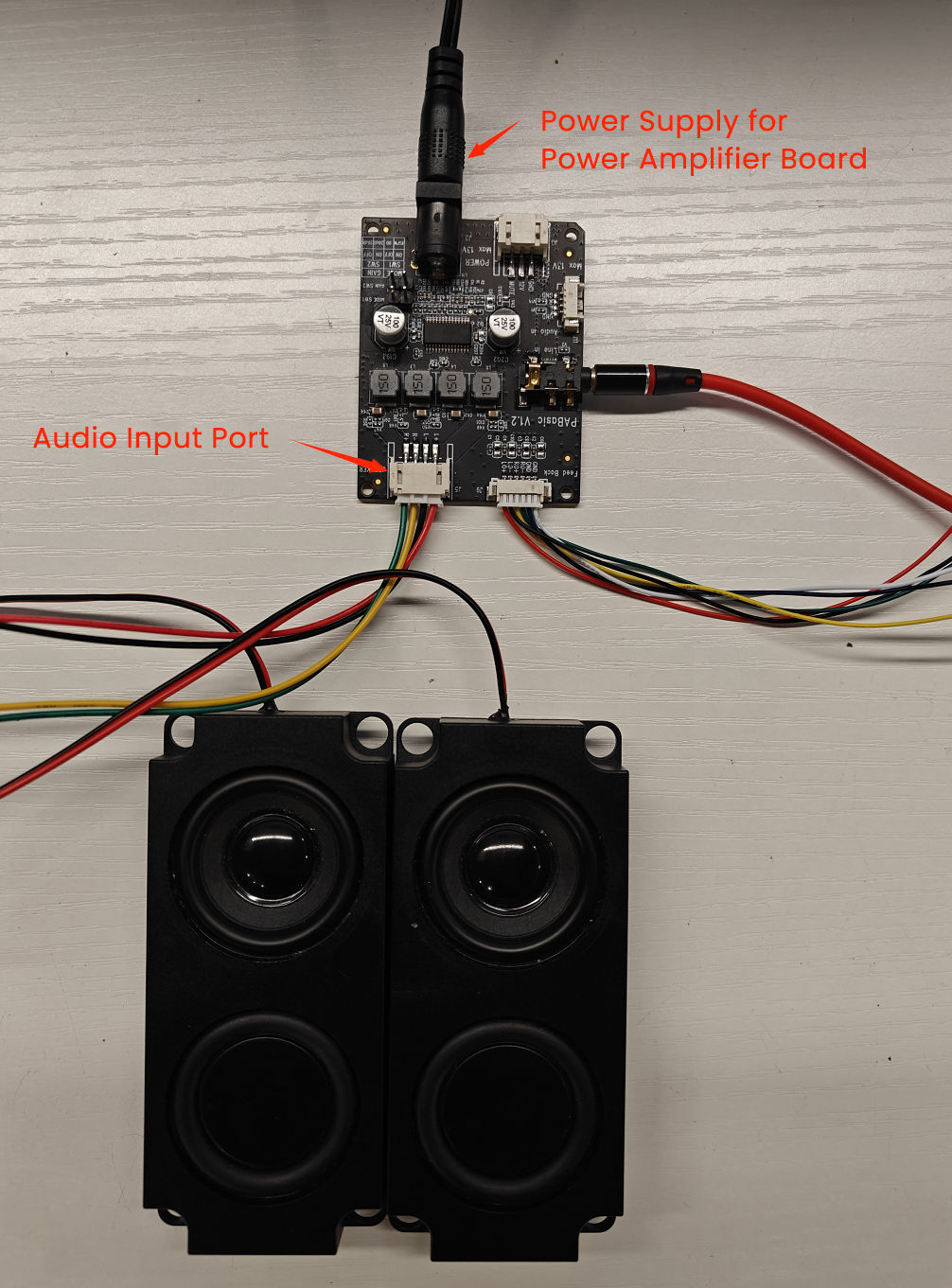

11.7 Audio Kit
The audio kit recommended by APLUX includes three parts: HSY full-range speaker, Yuliang power amplifier board, and SBC microphone. The following will introduce how to connect these three parts.
11.7.1 Preparation
  • Rhino Pi A1
  • HSY 1.5-inch full-range speaker with sound cavity
  • Yuliang power amplifier board
  • SBC microphone
  • Several other connecting cables

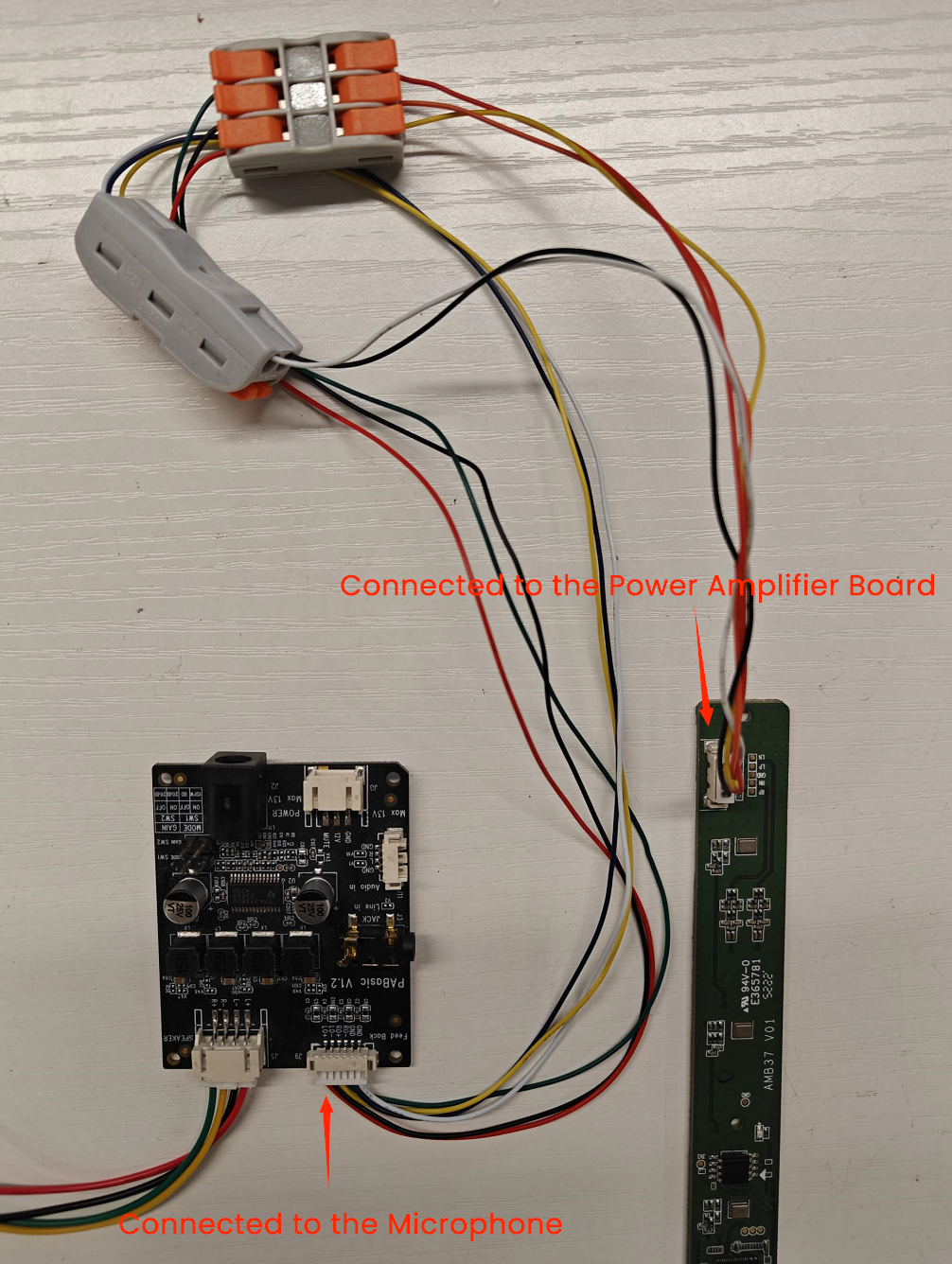

11.7.2 Hardware Connection
  • Overall Connection Diagram: alt text
  • HSY Speaker Connected to Yuliang Power Amplifier Board
For the HSY Speaker: the red cable is positive, and the black cable is negative. Connect them to the "L+" or "R+" (for positive) and "L-" or "R-" (for negative) terminals on the power amplifier board respectively. If there are two speakers, they need to be connected to the left and right channels of the power amplifier board separately (i.e., one speaker to "L+" and "L-", and the other to "R+" and "R-"). alt text
  • One side of the SBC microphone is connected to the Yuliang power amplifier board.
The LP, LN, GND, RP, and RN terminals of the microphone are connected to the LO+, LO-, GND, RO+, and RO- terminals of the power amplifier board respectively. Note: There are two GND terminals on the power amplifier board, and both need to be connected to the GND terminal of the microphone.
LP - LO+
LN - LO-
GND - GND
RP - RO+
RN - RO-
  • The other side of the SBC microphone is connected to the USB port of the Rhino Pi A1.
A DIY cable is required. Wire sequence: Connect the 5V, DP, DM, and GND (of the microphone) to the 5V (red), Data+ (green), Data- (white), and GND (black) of the stripped USB cable respectively.
  • The power amplifier board is connected to the USB port of the Rhino Pi A1
The 3.5mm audio interface of the power amplifier board is connected to the USB-to-3.5mm interface converter, and then plugged into the USB port of the Rhino Pi A1.

Install the Conversion Tool
sudo apt install sox libsox-fmt-all
Start Conversion
sudo sox output16k.wav -r 44100 output44k.wav
  • Start playing the recorded audio
Note that the parameters in the command must be consistent with the values retrieved in the previous step. For example, -f refers to the sample format, -r refers to the sample rate, and -c refers to the number of channels.
sudo aplay -D hw:1,0 -f S16_LE -r 44100 -c 2 output44k.wav
11.8 DYP-A02YY-V2.0 Ultrasonic Sensor
11.8.1 Preparation
  • Rhino Pi A1
  • DYP-A02YY-V2.0 Ultrasonic Sensor (output mode: RS485; UART output is also an optional choice)
11.8.2 Hardware Connection
  • The sensor requires a minimum supply voltage of 5V. However, since the 5V pin and GND pin of the Rhino Pi A1 are still under debugging, an external power supply is used to power the sensor in this example.
  • Connect the RS485A and RS485B pins of the ultrasonic sensor to the RS485A and RS485B pins of the Rhino Pi A1 for communication.
11.8.3 Test
The Dianyingpu Ultrasonic Sensor requires manual sending of a distance measurement command to obtain a distance measurement result. One result will be obtained each time the command is sent.
1、Since the test tool minicom cannot be set to input hexadecimal data to control the sensor for distance measurement, a script can be written to convert the data format (from decimal to hexadecimal) and then send the data to the serial port device number for control. The content of the script is as follows:
#!/bin/bash
if [ "$#" -ne 2 ]; then
    echo "Usage: $0 [Serial Port Device] [Hexadecimal Data]"
    exit 1
fi
# Serial port device, e.g., /dev/ttyS2
SERIAL_PORT=$1
# Hexadecimal data, e.g., '1F2E3D4C'
HEX_DATA=$2
# Convert the hexadecimal data into a binary stream and send it to the serial port
printf "$HEX_DATA" | xxd -r -p > $SERIAL_PORT
2、Use the script to send the control command: sudo ./send_hex.sh /dev/ttyHS1 '01030100000185F6'
/dev/ttyHS1: RS485 device number of Rhino Pi A1
01030100000185F6: Used to read processed value data; there are also other commands. For details, please refer to the Dianyingpu product manual
3、Use the minicom tool to receive data in AidLux. (If not installed, install it via sudo apt update; apt install minicom). Open minicom with the command: sudo minicom -D /dev/ttyHS1 -b 9600 -H
-b 9600: Set the baud rate to 9600 (the default baud rate of the sensor is 9600)
-H: Display data in hexadecimal format
11.9 Nooploop TOF Sensor
11.9.1 Preparation
  • Rhino Pi A1
  • Nooploop TOFSense Series TOF Sensor
  • USB to 4CH TTL Serial Port Expansion Device
11.9.2 Hardware Connection
Use the CH344 serial port device to connect the VCC, GND, TX, and RX of the TOF sensor to the VCC, GND, RX, and TX of any UART port on the CH344 device. The UART0 port is used in the current example.
11.9.3 Test
After the connection is completed, open the minicom tool in the AidLux terminal (if not installed, use the command sudo apt update; sudo apt install minicom to install it).
sudo apt update;sudo apt install minicom
After installation, open the serial port:
sudo minicom -D /dev/ttyCH343USB0 -b 921600 -H
The default baud rate of the TOF sensor is 921600, and it requires data to be displayed in hexadecimal format.
Note: If minicom only displays one line, please make the following settings:
Press CTRL-A + Z to enter the minicom settings page, then press W to enable line wrapping for display.
Below is an example of the received data.
