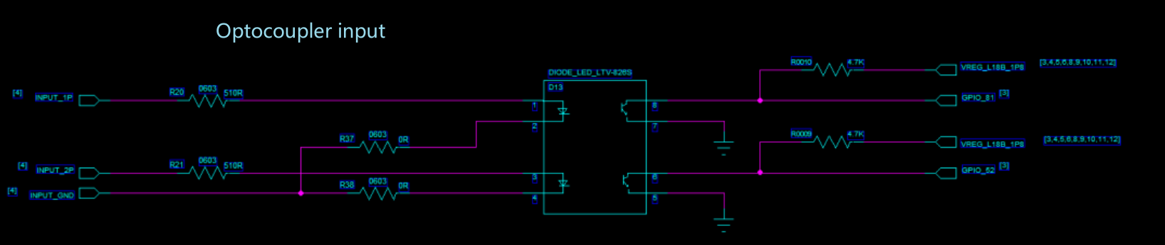

Two optocoupler input circuits
The D13 device is an optocoupler device. The optocoupler input terminal is connected to the external device through the smart camera 20pin connector. The optocoupler output terminal is connected to the smart camera main control (that is, the external device controls the smart camera through optocoupler isolation). INPUT_1P and INPUT_2P are two inputs. signal, INPUT_GND is the common ground of the two input signals.
Note : Since the optocoupler input voltage is determined by the external device, in order to meet the optimal input current of 20ma optocoupler input, the external device can configure the resistance values on the two input signals INPUT_1P and INPUT_2P. Currently, the smart camera is configured with a 510 ohm resistor by default. The voltage range is 5~20V, and the recommended input voltage is 10V. If there is a special voltage input, please ask the external device to configure the resistor by itself.

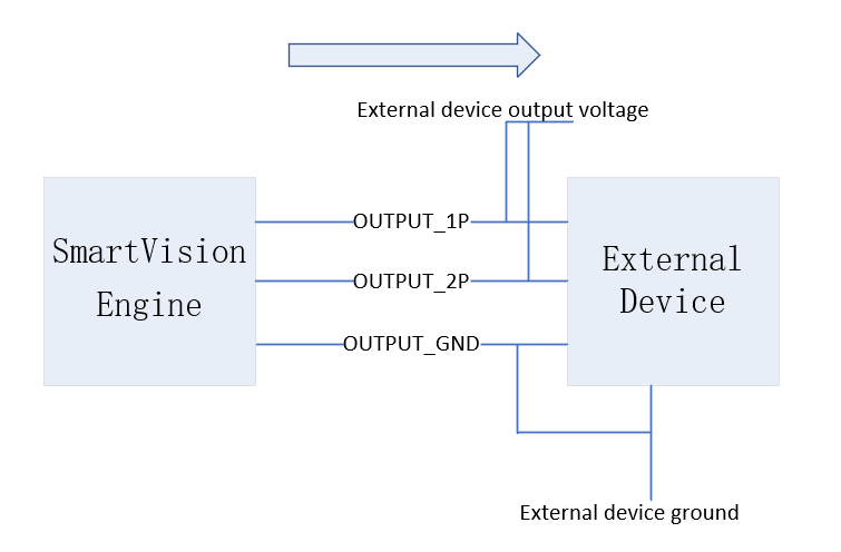

Optocoupler output signal
OUTPUT_1P and OUTPUT_2P are two output signals, OUTPUT_GND is the common ground of the two output signals, and the output voltage of the external device should not exceed 80V.

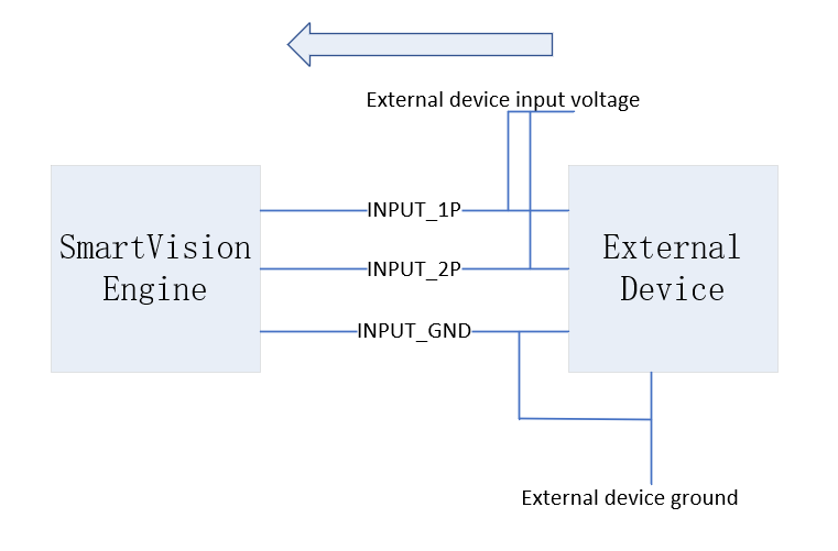

Optocoupler input signal
INPUT_1P and INPUT_2P are two input signals, and INPUT_GND is the common ground of the two input signals. The external input voltage range is 5~20V, 10V is recommended. If you need to change the input voltage range, you can connect series resistors to the external device INPUT_1P and INPUT_2P signals according to specific needs.
