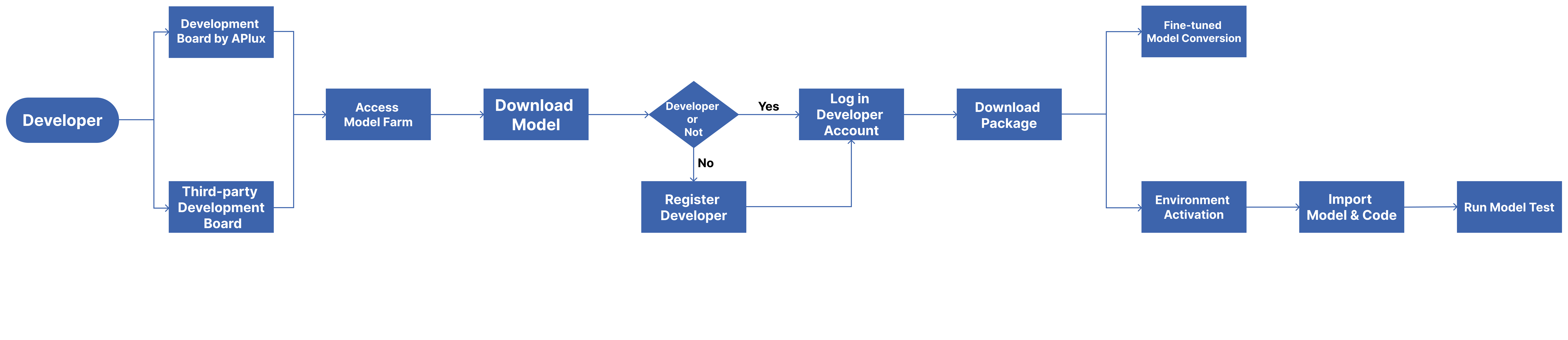

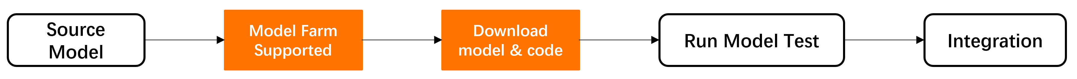

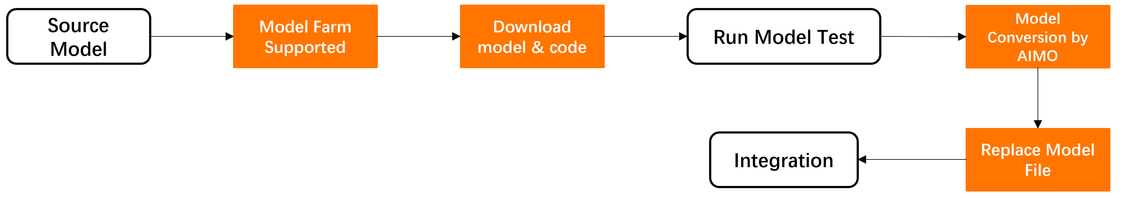

The following steps showed a AI model deployment on an edge device through Model Farm:
Additionally, we provide a specific example to help developers get started with Model Farm more quickly: Deploy YOLOv5s Model to Qualcomm QCS8550 through Model Farm

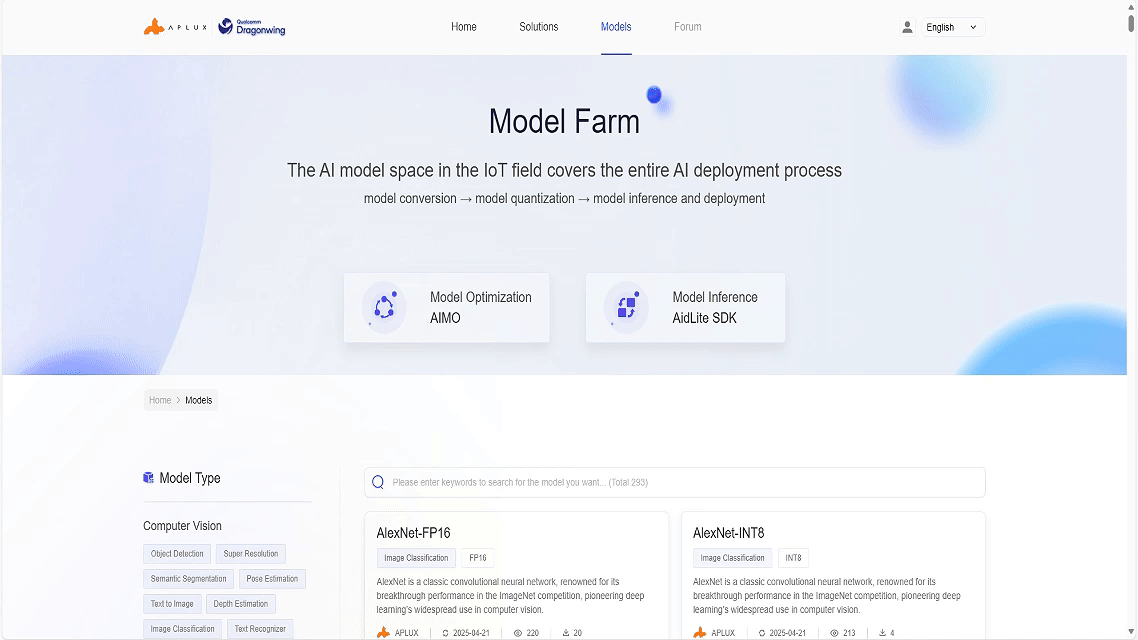

Please visit Model Farm

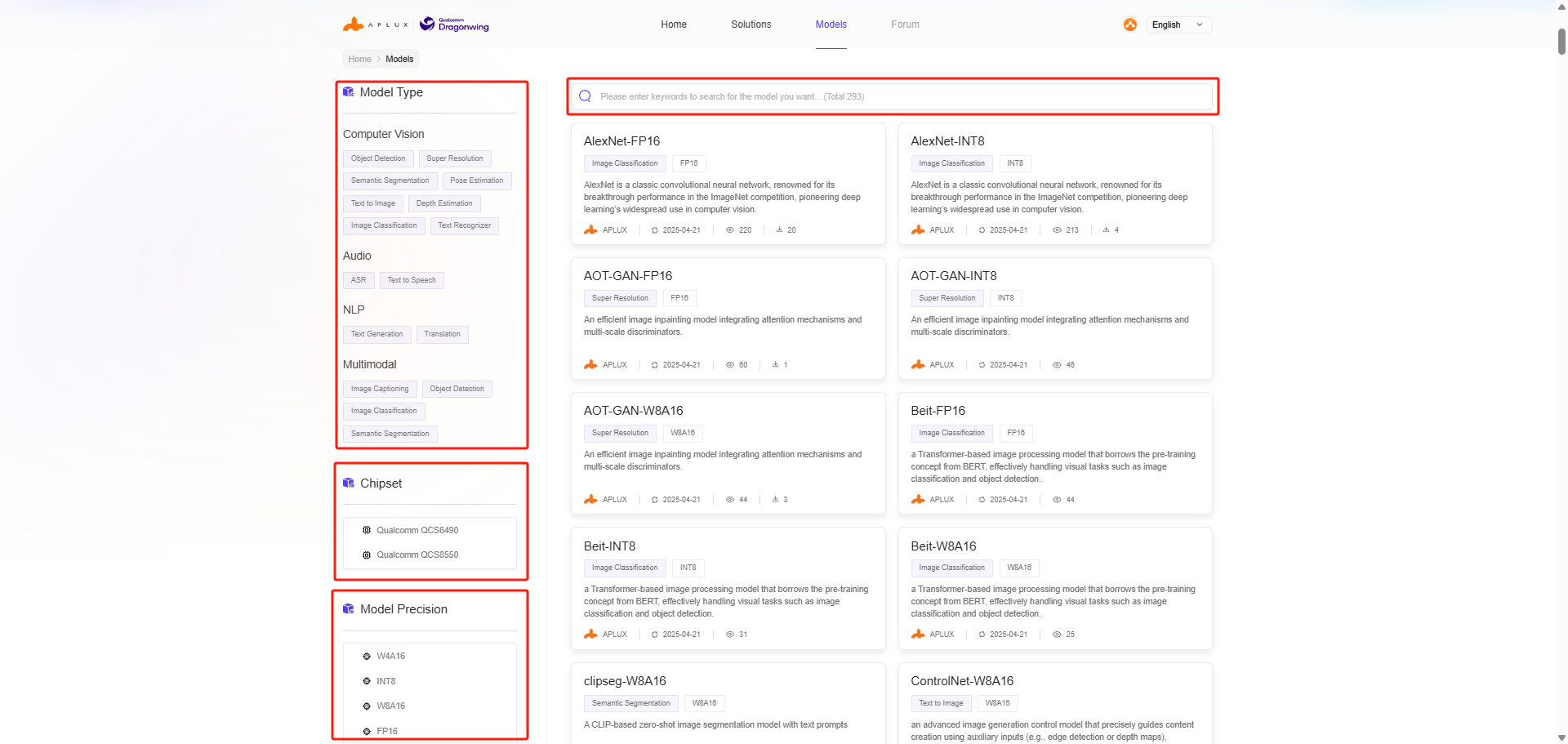

Model Farm provides multiple ways to filter and find models:
  • Filter by model type
  • Filter by model data precision
  • Filter by chip type
  • Keyword search

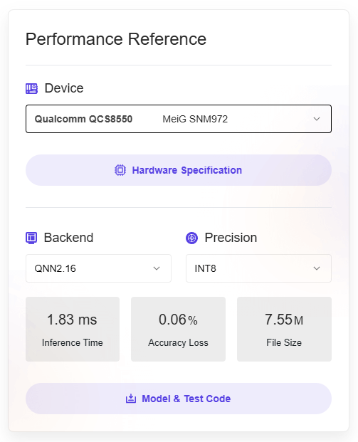

Model Performance Reference
The model details page on Model Farm provides AI model performance reference on corresponding devices.
  • Device: Development board and corresponding chip used for model testing
  • Backend: AI Framework and version used for model conversion and inference
  • Precision: Precision of optimized model
  • Inference Time: model inference time cost, excluding pre/post-processing
  • Accuracy Loss: Cosine similarity of output matrices comparing the source model (FP32) with the optimized model
  • Model Size: File size of the optimized model
💡Note
For the same SoC, model performance is only reference data for devices with different hardware specifications

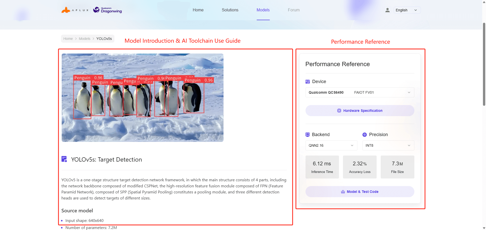

Taking YOLOv5s on MeiG SNM972 (QCS8550) as an example:
Performance Reference Display

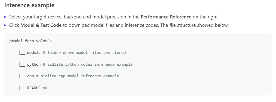

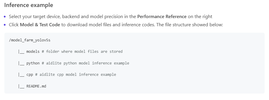

AidLite SDK supports all models inference on Model Farm. Additionally, Model Farm also provides pre/post-processing code, ensuring developers can quickly view model effects.
Through the Download Models step, developers can obtain a complete model file and inference code package with the following file structure (using YOLOv5s as an example):
/model_farm_yolov5s
    |__ models # Model files
    |__ python # Python-based model inference code
    |__ cpp # C++-based model inference code
    |__ README.md # Model information description & related software dependency installation guide

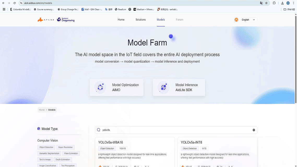

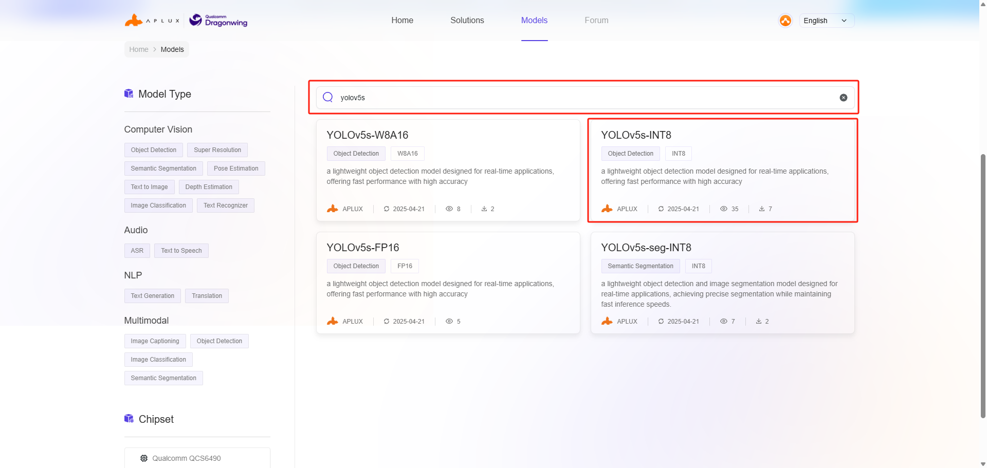

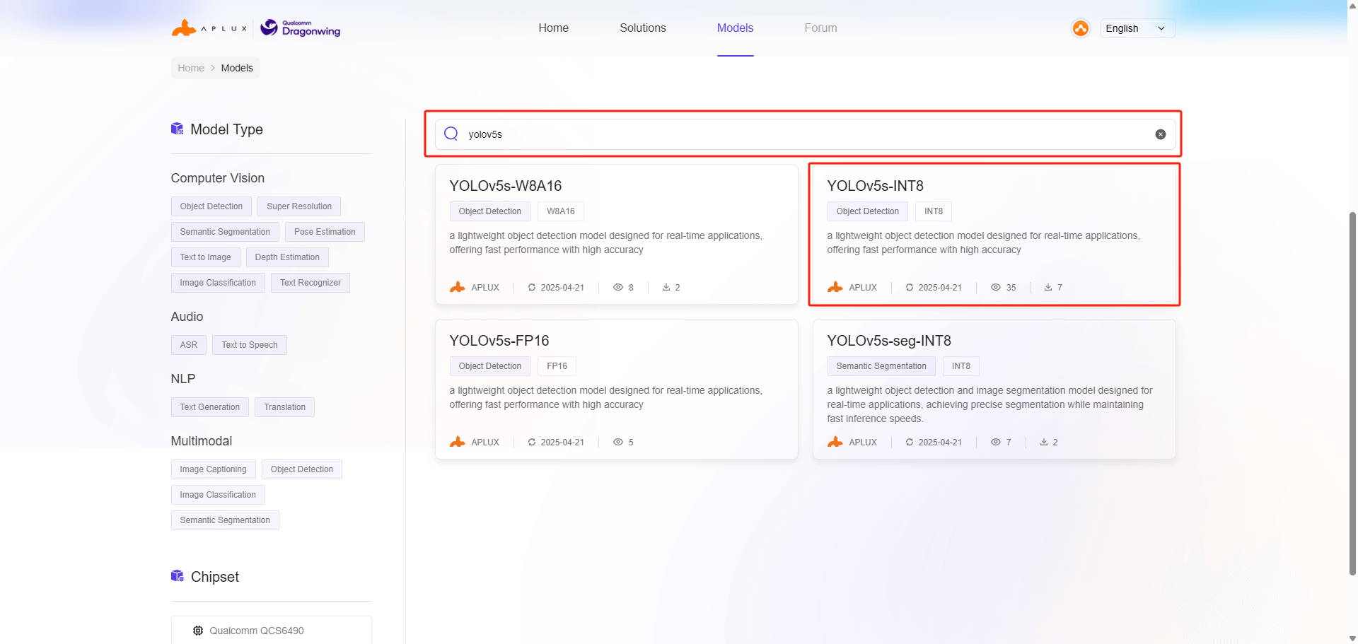

Step 1: Visit the website and find the model
Developers can directly access Model Farm through a web browser: https://aiot.aidlux.com/en/models
By keyword search for the YOLOv5s model in the search bar, developer can find different precision YOLOv5s models. For this case, we select INT8 quantization precision and click on the YOLOv5s-INT8 model card to view model details.
Step 2: View model performance
On the model details page, the left side showed model introduction and related tool guide, and the right side floating window displays the reference performance of the model on corresponding hardware
We choose the MeiG SNM972 device (QCS8550) as the reference hardware and can see the performance metrics of YOLOv5s with INT8 precision, as shown in the figure below:
💡Note
The inference time metric refers to the execution time of the model, excluding pre/post-processing code

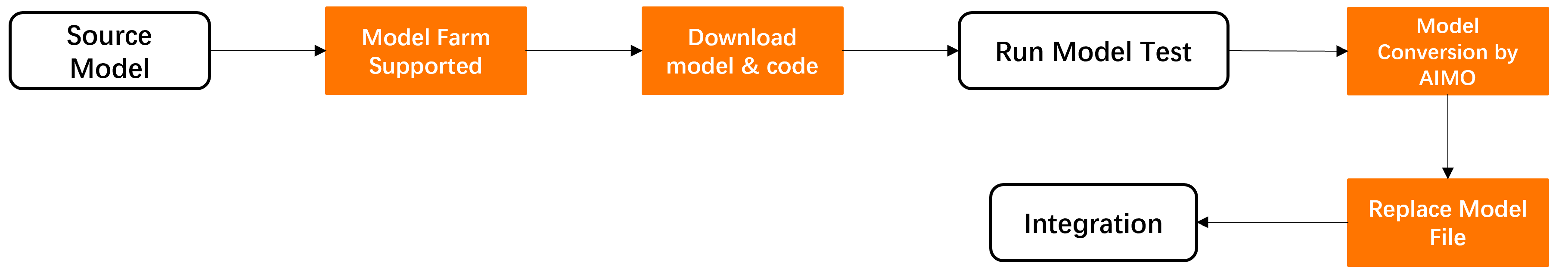

Step 6: Convert fine-tuned models and inference
When developers want to test the running effect of their fine-tuned YOLOv5s model on QCS8550, Model Farm provides reference steps for using AIMO to convert the YOLOv5s model.
AIMO model conversion reference steps can be viewed in the following two places:
  • In the Performance Reference section on the right side of the model details page, click Model Conversion Reference to access it.
  • View in the Model Conversion Reference section in the README.md file of the code package.
Developers can refer to these steps to use AIMO to convert their own YOLOv5s model. For introduction and usage of AIMO, please refer to: Model Optimization Platform AIMO User Guide
After model conversion, developers can replace the YOLOv5s model file in the code package and run the test case again to check the effect.
