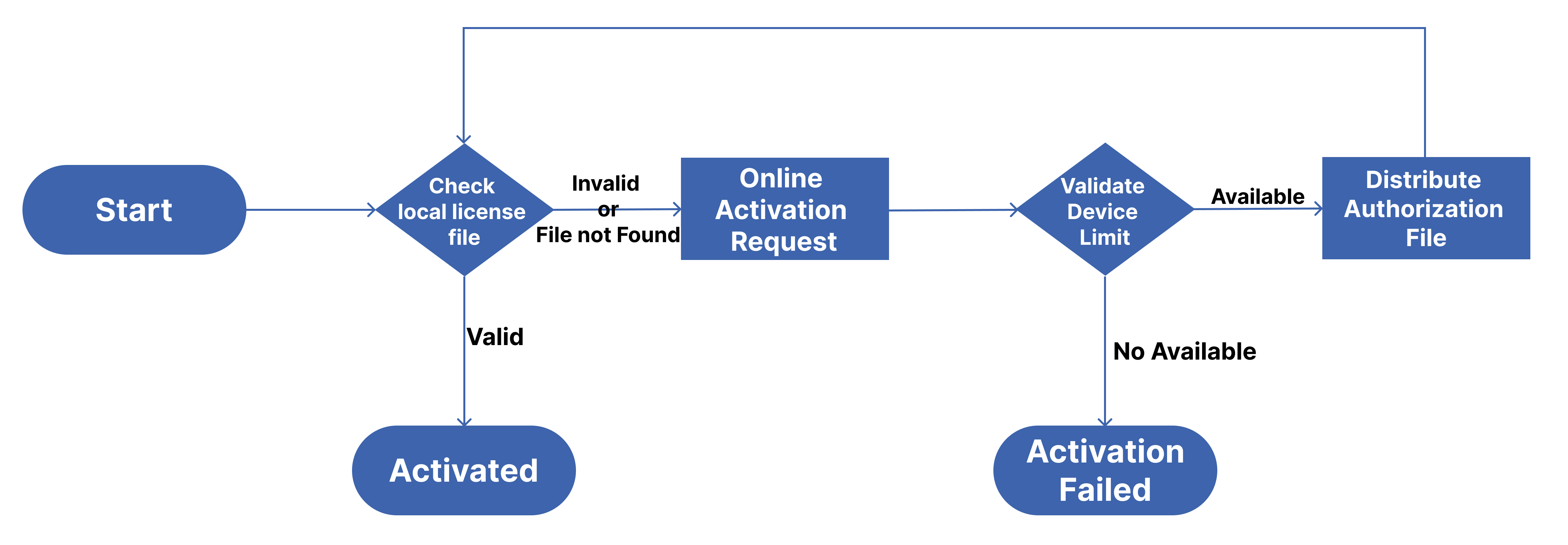

The development kits provided by APLUX must be used in an activated environment. Activation is performed through the LMS component included in the AidLux SDK.
LMS activation uses an online-first authorization approach, followed by offline license validation. The workflow is shown below:
