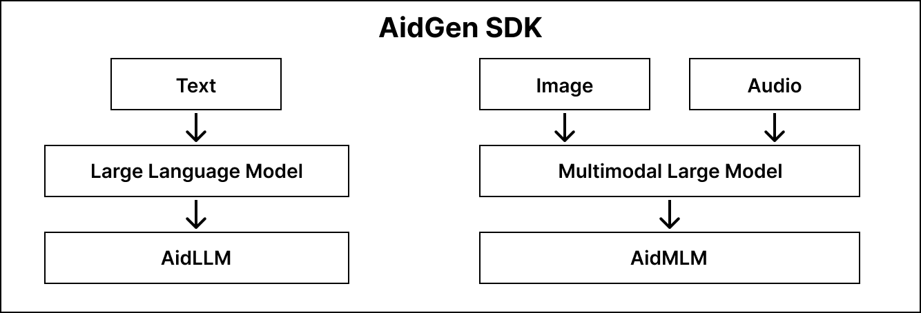

AidGen is an inference framework specifically designed for generative Transformer models, built on top of AidLite. It aims to fully utilize various computing units of hardware (CPU, GPU, NPU) to achieve inference acceleration for large models on edge devices.
AidGen is an SDK-level development kit that provides atomic-level large model inference interfaces, suitable for developers to integrate large model inference into their applications.
AidGen supports multiple types of generative AI models:
- Language large models -> AidLLM inference
- Multimodal large models -> AidMLM inference
The structure is shown in the diagram below:
