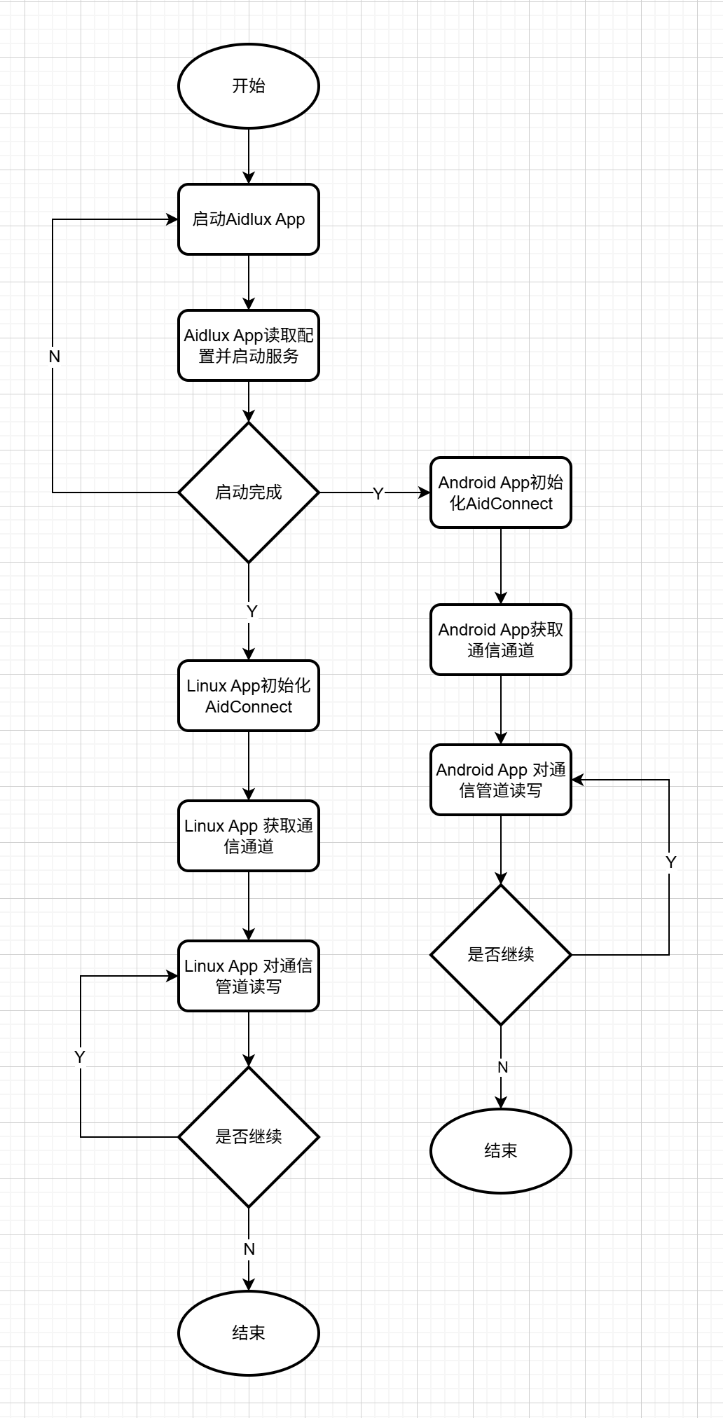

Taking a third-party application calling AidLux's AI inference capability as an example, the complete workflow is: the user configures the communication channel name and size in the AidLux App, or adds them via the Android SDK interface. If configured manually, restart the AidLux App for the channels to take effect; channels added via the SDK take effect immediately without restart. The Android App obtains the configured channel and writes source data to it. The Linux side of AidLux App reads data from the corresponding channel, performs AI operations, and writes the AI-processed results to another configured channel. The Android App then reads the AI result data from the other channel and executes subsequent application logic.
