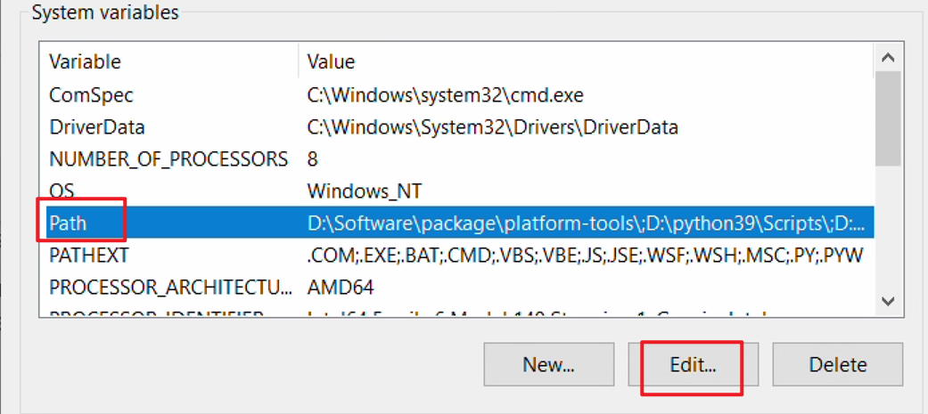

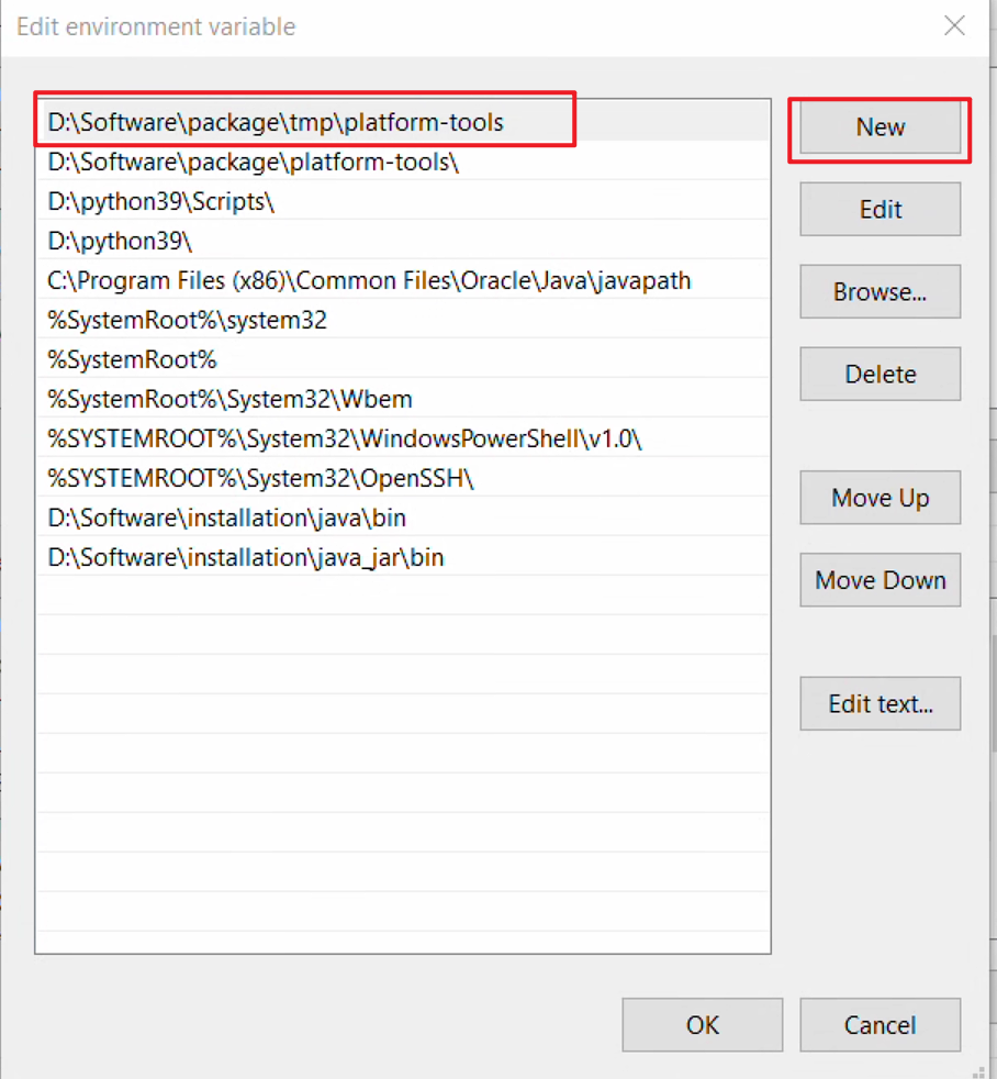

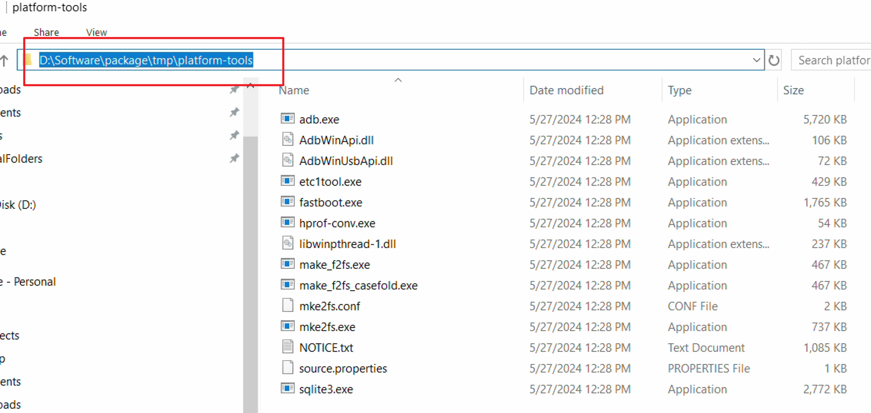

2.1.2.2 Configure ADB Environment Variables
  • Copy the path of the unzipped platform-tools folder.

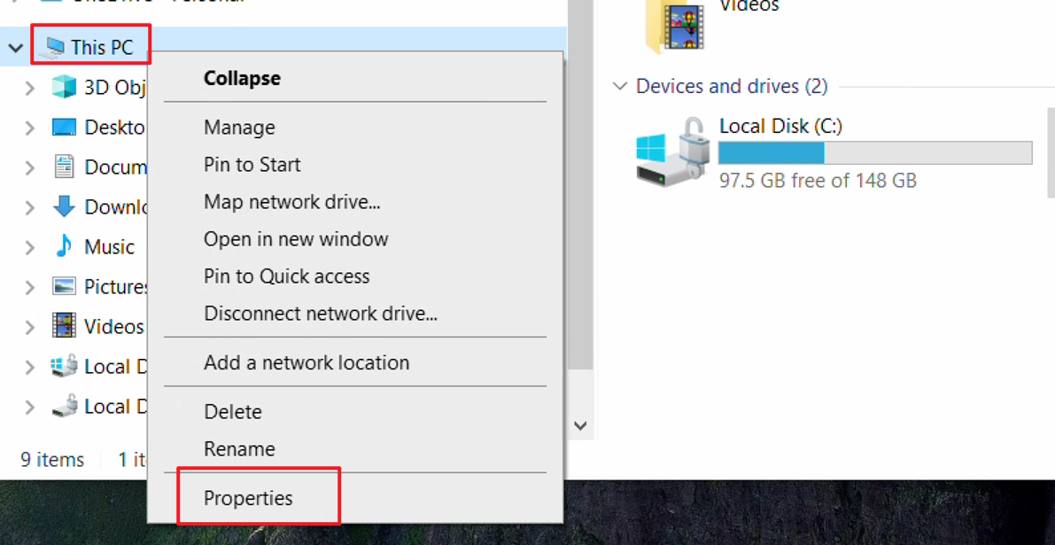

  • Right-click This PC and select Properties.
  • In the pop-up settings window, click Advanced system settings.
  • In the System Properties window (Advanced tab), click Environment Variables.
  • In the Environment Variables window, select the Path variable under System Variables and click Edit.
  • In the Edit Environment Variable window, click New and add the platform-tools path copied earlier.
  • Click OK sequentially to save the configured variables and exit.

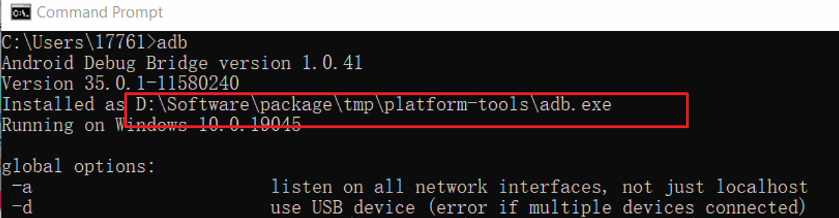

2.1.2.3 Verify ADB Environment Configuration

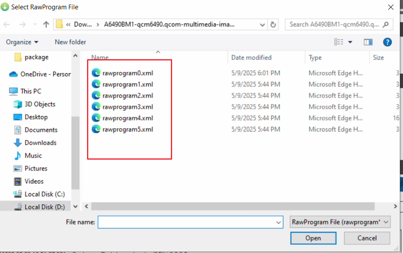

2.1.3 Flashing Tool Installation

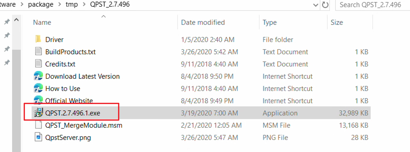

  • Unzip the QPST_2.7.496.zip file to the current folder.
  • Go to the unzipped QPST_2.7.496 directory and double-click the QPST.2.7.496.1.exe program to start installation.
  • Follow the prompts and keep clicking Next to complete the installation.
  • Default installation path after completion: C:\Program Files (x86)\Qualcomm\QPST\bin.
  • Enter this directory and send the QFIL.exe program to the desktop.
  • The desktop icon is as follows:

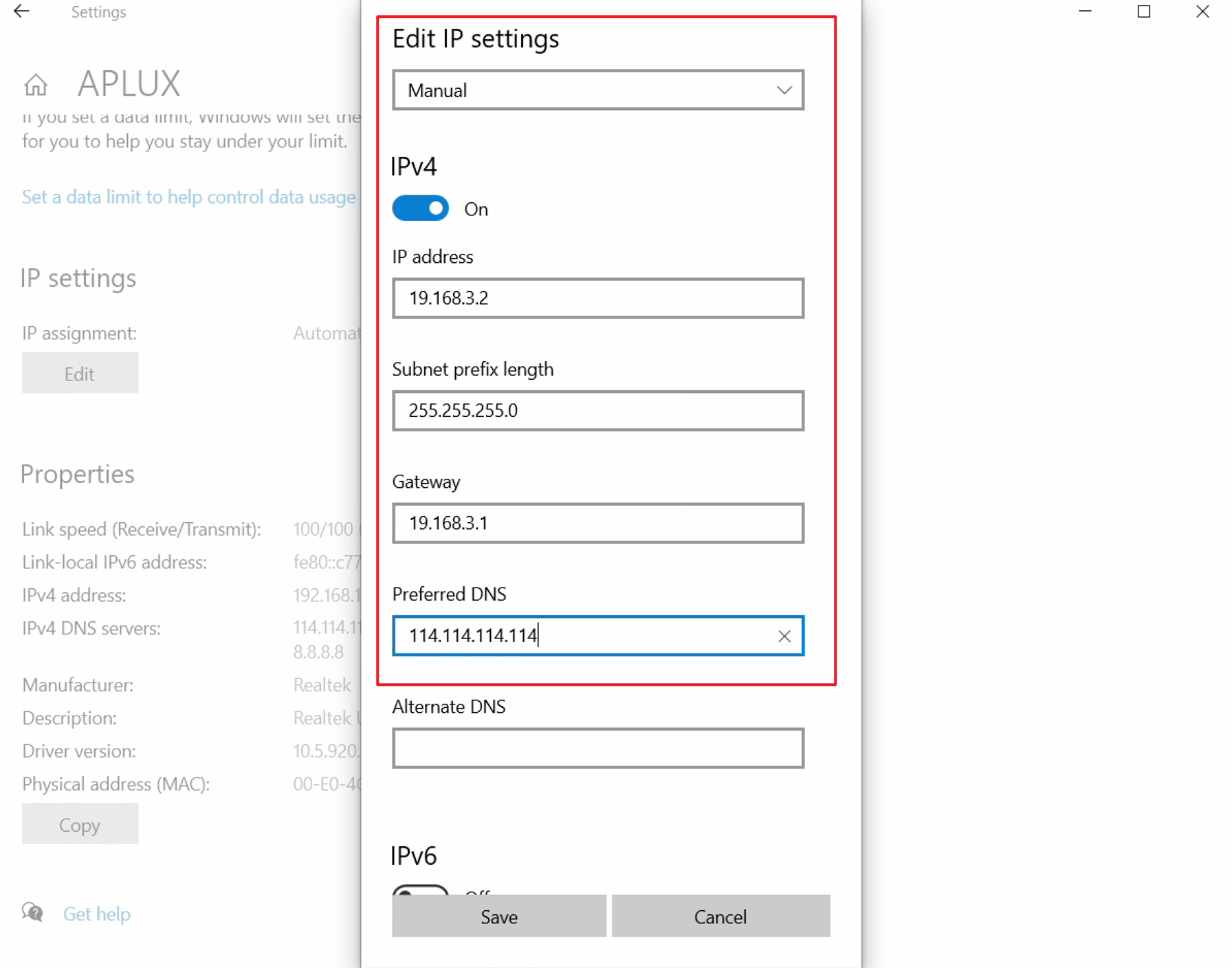

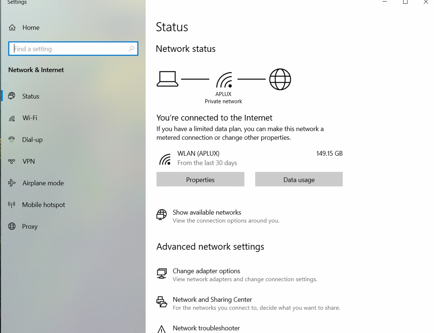

3.2.1 Configure Static IP for the Windows Computer
  • Press the Win+X key combination to open the system shortcut menu, select Network & Internet, and click Ethernet in the pop-up window.
  • In the Ethernet window, find the IP assignment section and click the Edit button to configure a static IP.
  • In the IP settings, select Manual, enable the IPv4 toggle, and edit the IPv4 address, subnet mask, etc., as needed.
💡Note
The IP address, subnet mask, gateway, and DNS information in the example image are for reference only. Configure them according to your actual network environment.
  • Click Save to apply the network configuration.

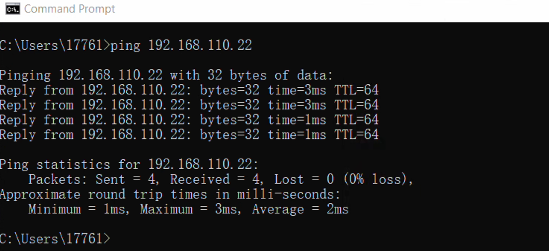

  • After configuring IP addresses for both the Windows computer and AIBox, test connectivity by pinging the AIBox from Windows. If the ping is successful, the configuration is valid. If not, check the network settings.

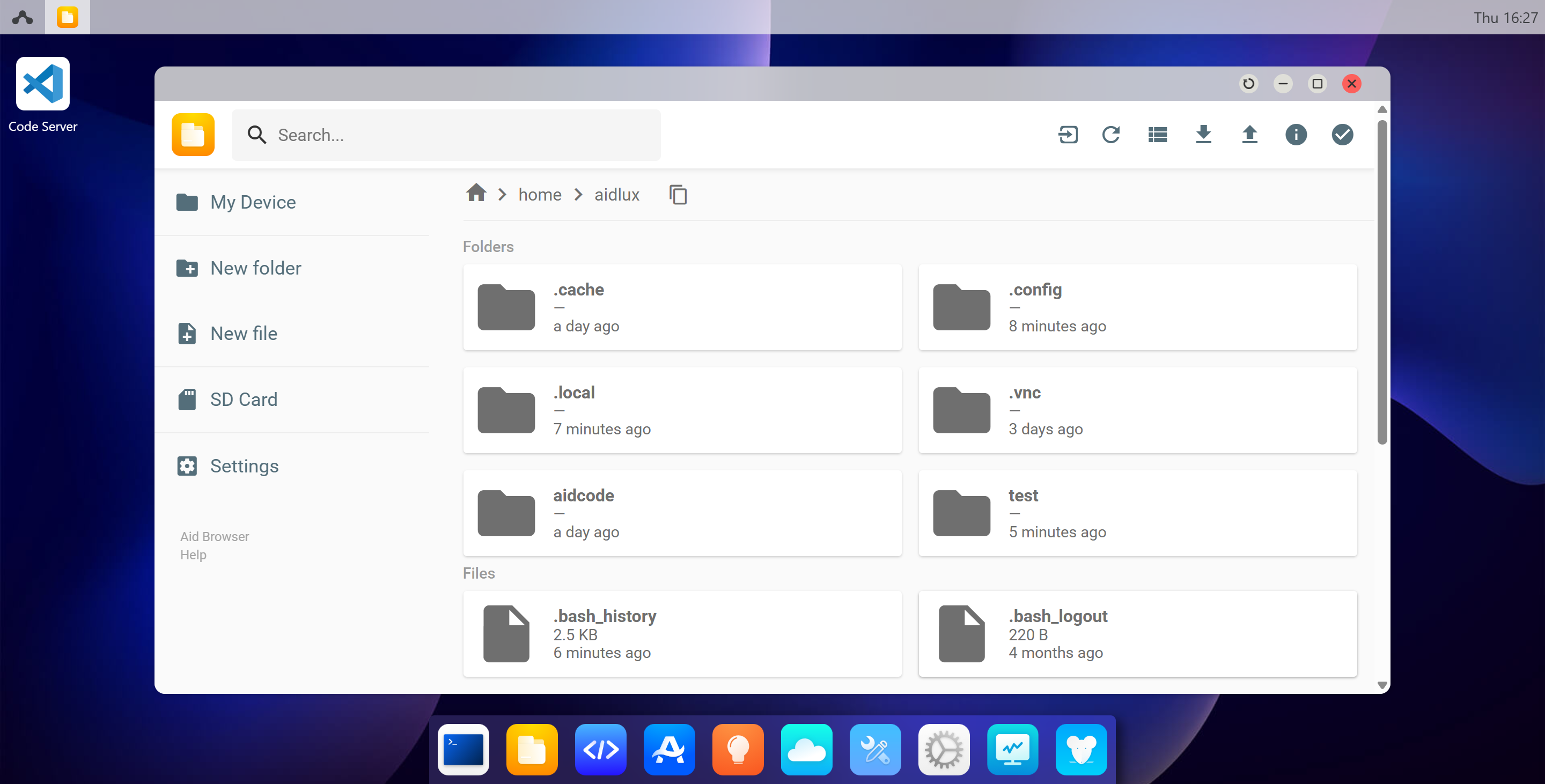

This method allows direct login to the Aidlux system's Desktop.

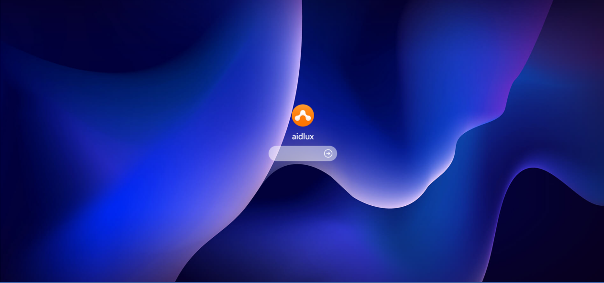

  • Enter the URL http://AIBox_IP:8000/login in a browser (replace AIBox_IP with the actual IP configured in the previous steps).Username/Password: aidlux/aidlux
  • After logging in, click the first icon labeled Terminal at the bottom to use the command line.

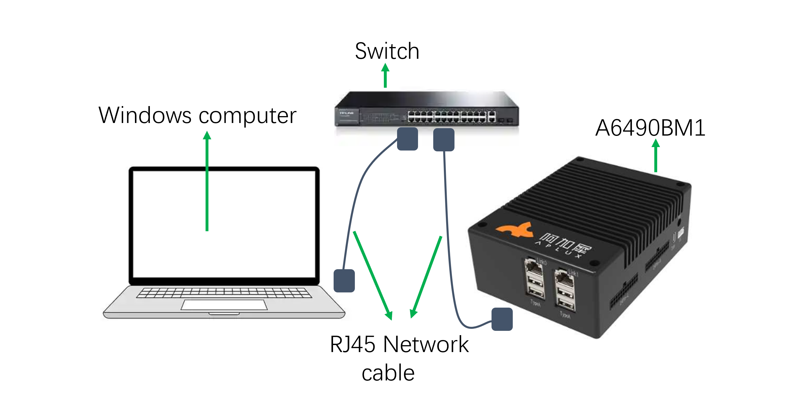

3.3 Wired LAN Connection
When the development environment has a local area network (LAN) with a DHCP server to assign IP addresses to connected devices, use the following steps to connect to and access the Aidlux system:
Network Diagram:

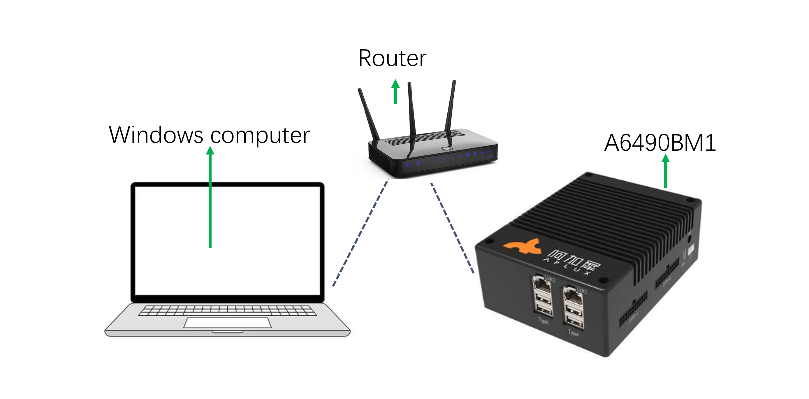

3.4 Wireless LAN Connection
The AIBox supports Wi-Fi connectivity. To connect to the AIBox via a LAN Wi-Fi network, follow these steps:
Network Diagram:
3.4.1 Connect/Disconnect to Wi-Fi on AIBox
  • Open a terminal on Windows and run:
  • Scan for available Wi-Fi networks:
💡Note
Use the up/down arrow keys to view all APs. Press CTRL+C to exit the scan interface.
  • Connect to a specific AP:
nmcli dev wifi connect WiFi-SSID password WiFi-password
💡Note
Replace WiFi-SSID with the network name and WiFi-password with the password.
  • Check the connection status:
nmcli general status
  • View the assigned IP address:
ifconfig wlan0
  • Disconnect from the AP:
nmcli con down ssid/uuid
3.4.2 Verify Network Configuration
Tip
3.4.4 Remote Login via SSH
Tip
This method allows remote login to Aidlux via SSH but does not provide access to the Desktop.
  • Open a terminal window on Windows and execute(Replace AIBox_IP with the device’s actual IP address.):
ssh aidlux@192.168.111.122 -p 2222
  • aidlux user: aidlux/aidlux
  • root user: root/P@ssw0rd
Follow the steps above to access the Aidlux system.

5.1 File Transfer via SCP
SCP transfer requires the A6490BM1 to be connected to the network. If the AIBox's IP address is 192.168.110.194, enter the following commands in the terminal:
Tip
Enter ifconfig in the AIBox's terminal to check the current IP address.
  • To upload the file test.txt to the /home/aidlux/ directory from a PC terminal, use:
  • To download a file from the AIBox to the PC's current directory, use:

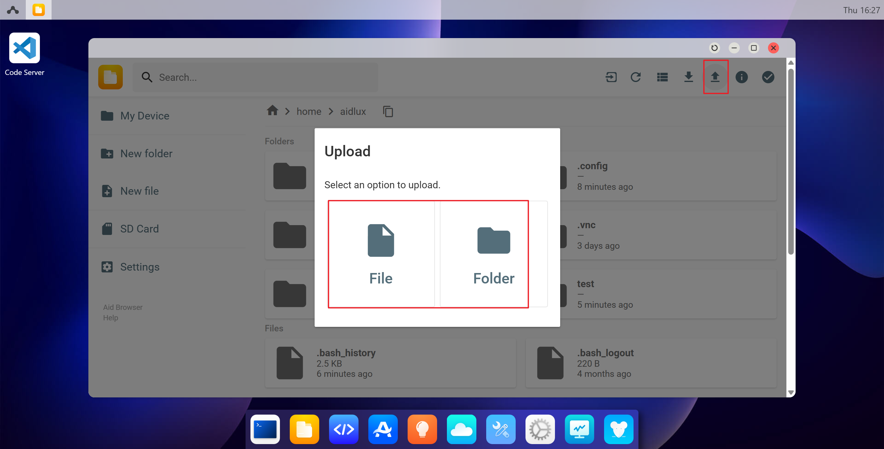

5.2 File Transfer via Aidlux File Browser
File transfer via the Aidlux file browser requires the A6490BM1 to be connected to the network. If the AIBox's IP address is 192.168.110.194, follow these steps:
Tip
  • Enter the URL http://192.168.110.194:8000/ in a browser to log into the Aidlux desktop environment (password: aidlux). After logging in, click the file browser icon to proceed.
  • Click the Upload button in the upper right corner to transfer files or directories to the /home/aidlux/ directory.

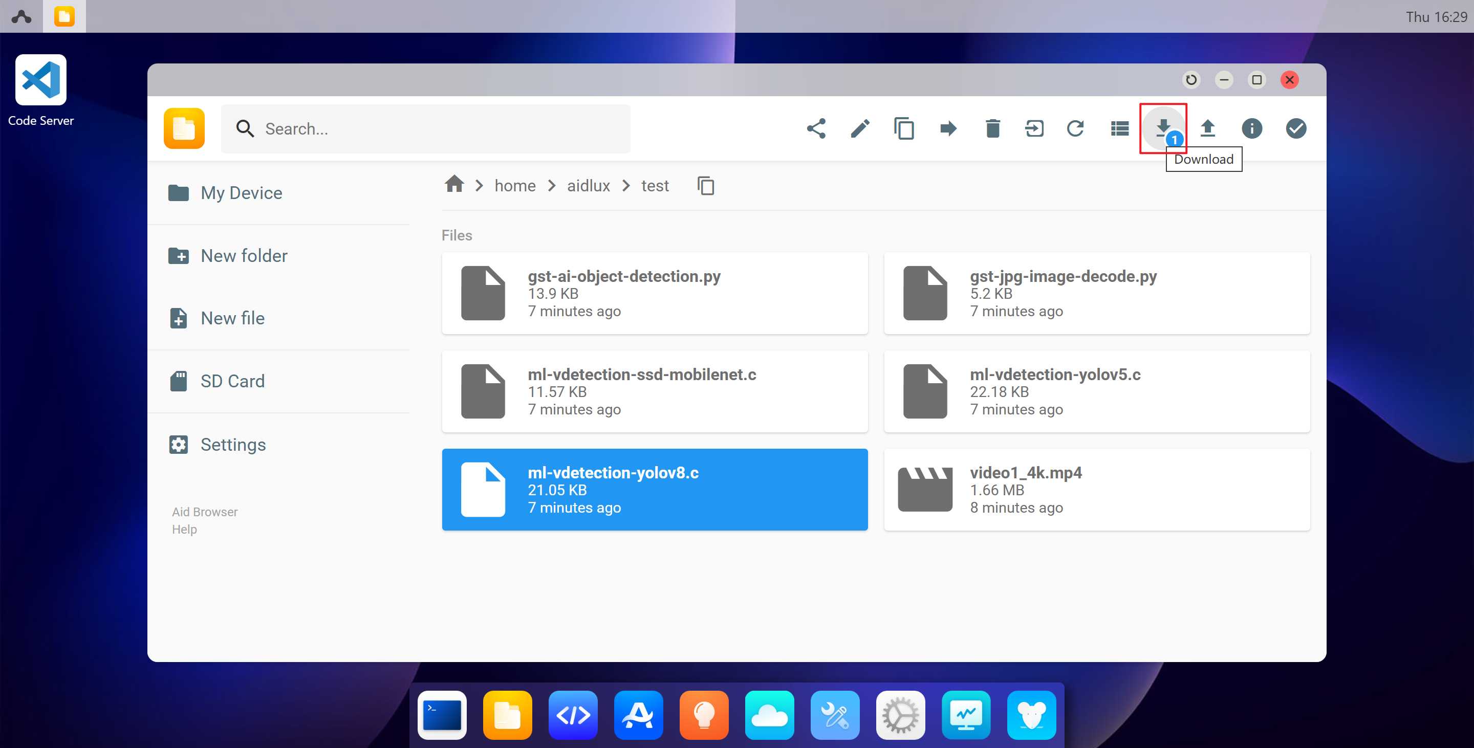

  • Click the Download button in the upper right corner to download files or directories from the /home/aidlux/ directory to your local machine.

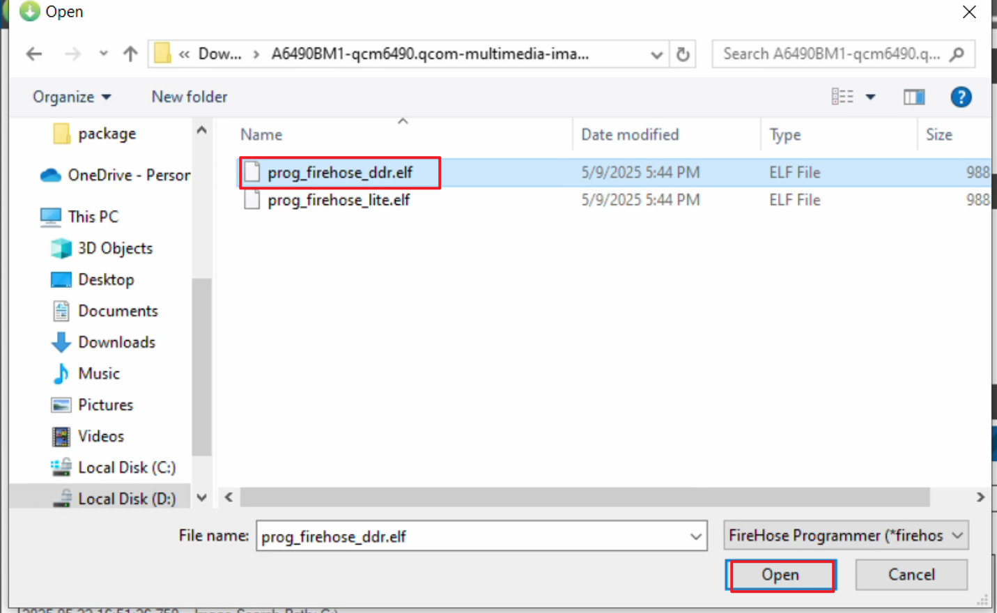

  • Unzip the ROM file.
  • Locate Select Programmer, click Browse... next to Programmer Path, navigate to the unzipped folder, and select the ROM file.
  • Double-click to select prog_firehose_ddr.elf.

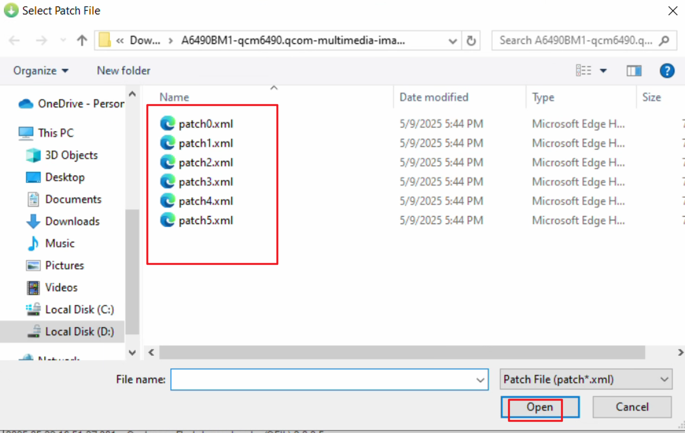

8.2.6 Select Flash XML File
  • Find Select Flat Build and click Load XML... to select the flash XML file.
  • In the pop-up window, select all XML files.
After selecting the XML file, another window will pop up automatically. Again, select all files.
