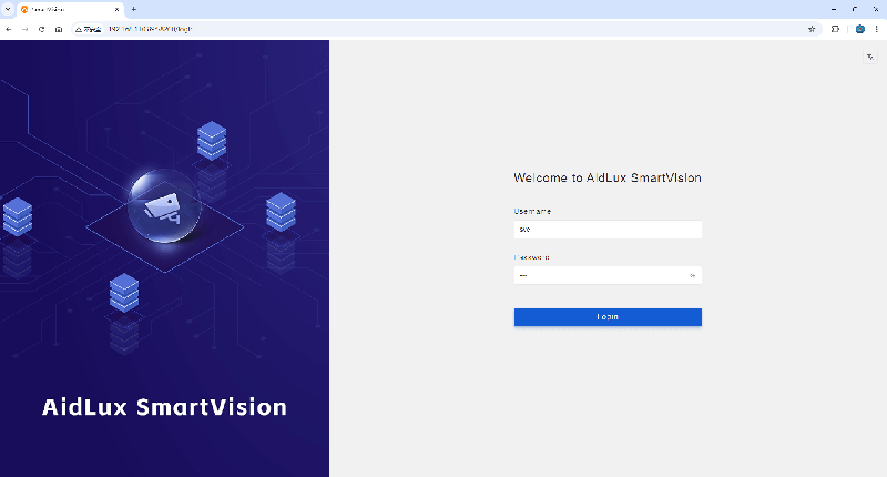

After connecting the intelligent camera to the power source, the device will automatically boot. When the power indicator turns solid red, it indicates that the device has started successfully.
After the device is connected and powered on, use a browser on the PC to log into the camera management interface by entering the following link: http://[Camera IP]:58200/
For example, if the default IP of the camera is 192.168.1.123 , enter the following URL in the browser: http://192.168.1.123:58200/
Enter the username and password in the web interface to access the device management page.
Default Username: sve Default Password: sve

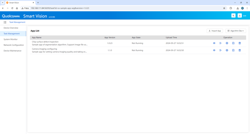

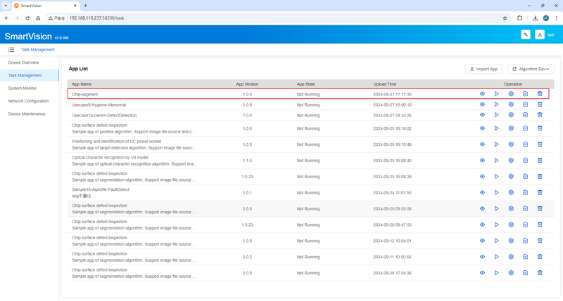

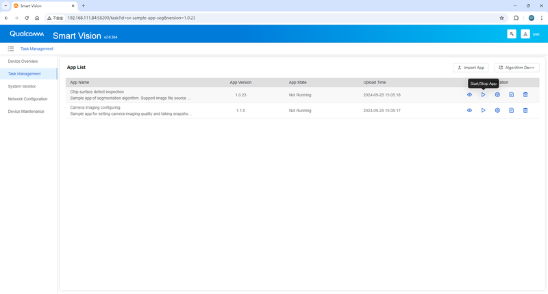

Application List
After the SmartVision Engine application is installed, two sample applications are built-in by default [Application Example (Picture Acquisition)] and [Application Example (Segmentation)]. The [Application Example (Picture Acquisition)] application does not include any inference and can be used for system and physical camera image capture debugging. The application list displays all AI application packages currently installed on the system, including the application name, version, status, and upload time. Taking [Application Example (Picture Acquisition)] as an example, we will explain the functions of the smart camera:
Enter the Runtime Preview Interface: Navigate to the "Runtime Preview" interface to view the original and result images produced during AI inference in real time.
Start ▪
Stop Application: Start or stop the AI application package.
Enter Imaging Settings Interface: Modify camera parameters, algorithm threshold parameters, and result data integration configurations.
View Application Runtime Logs: View the log information generated during application runtime.Delete Application: Remove unnecessary AI application packages.

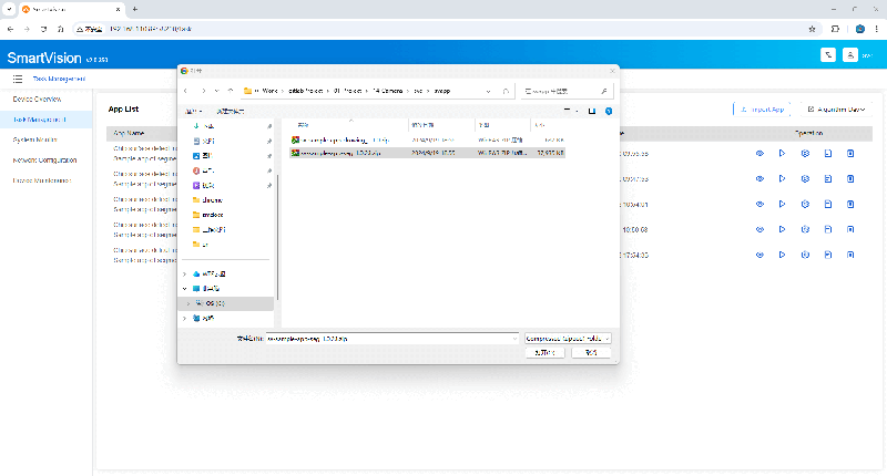

Click the Import Application Package button to upload user AI application packages (for details on package format, content, and how to build, refer to [Step 3: Build Your First Camera Application]).

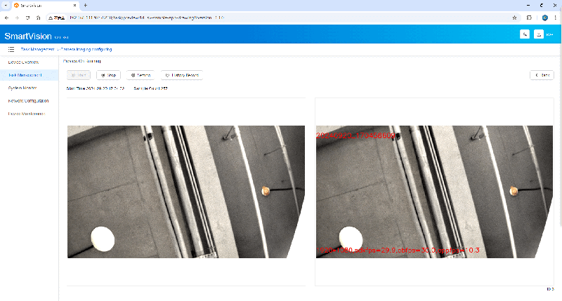

Runtime Preview
View real-time data of the original and result images from AI inference, as well as statistics on the number of samples. The sample count will reset to zero after each start.
Click Start and Stop buttons to control the start and stop of the AI application package. Based on the current application package status, the corresponding button will be dynamically enabled. Once the AI application is running, it will perform target detection and generate results. The left side shows the Original Image, and the right side displays the Result Image after inference. Below is an example of the built-in algorithm application in action.
Click the Settings button to jump to the Imaging Settings interface to modify parameters. Note: This button is disabled while the algorithm application is running.

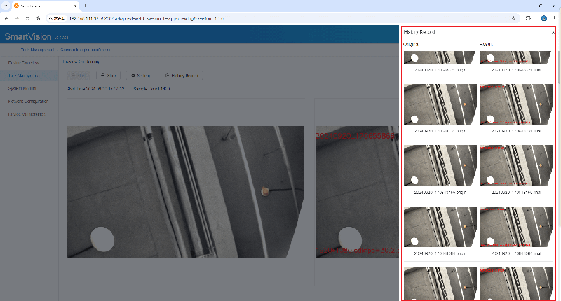

Click History to open a side panel displaying a history of original and result images after inference. Click any image to view it independently and use the Fullscreen, Zoom In, Zoom Out, and Rotate features.
Click the Back button to return to the Application List interface.

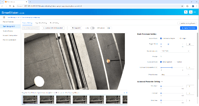

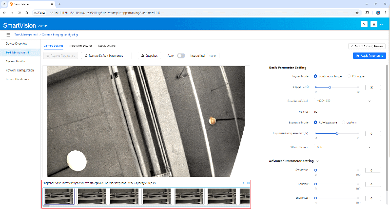

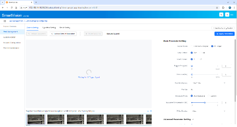

Imaging Settings
Adjust camera parameters to achieve optimal image quality. As shown below:
Trigger Method: Select between Continuous Trigger and IO Trigger modes.
When Continuous Trigger is selected, the configuration is automatically saved, and the camera will be opened. The captured images will be displayed in real-time. You can update camera parameters while the camera is active.

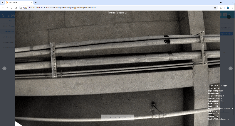

Click the Capture Snapshot button to take a photo of the current visible real-time image and display it below. Enable Auto to automatically take and store snapshots at preset intervals, displaying them below.
When IO Trigger is selected, the configuration is automatically saved, and the camera is opened. External trigger signals must be connected, and once received, a photo will be taken. The corresponding image and sample count will be displayed below.
The imaging settings page allows configuration of camera parameters, including trigger settings and image parameters.

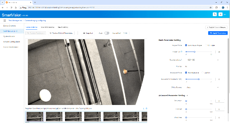

Basic Parameter Settings
- Trigger Method: When IO Trigger is selected, configure the Edge Setting and Trigger Delay (us). Edge settings include Rising Edge and Falling Edge. Select the input channel (1 or 2), and configure Trigger Delay and Debounce duration. The default delay is 0ms, and the default debounce is 5ms.
- Exposure Settings: When Auto Exposure is enabled, only Exposure Compensation is editable. When Custom is enabled, both Exposure Duration and Exposure parameters are editable.
- White Balance Settings: When Custom White Balance is disabled, it can be configured. It includes 7 white balance modes: Incandescent, Fluorescent, Warm Fluorescent, Daylight, Cloudy, Twilight, Shade.
Advanced Parameter Settings
- Saturation: Adjusts the purity or vividness of colors in the image.
- Contrast: Adjusts the difference between the lightest and darkest parts of the image.
- Sharpness: Adjusts the clarity of image edges.
- Custom White Balance: When enabled, you can adjust the Color Settings Mode, which includes Color Temperature and RGB Gain. If RGB Gain is selected, you can edit R Gain, G Gain, and B Gain.
Click Apply Parameters to save the changes. If the image does not look as good as the previous one, you can restore the previous settings by clicking Restore Parameters.
Snapshot images support One-click Export to Zip, One-click Delete, and Single File Delete. The system can store up to 200 snapshots, and when a new snapshot is taken, the oldest one is deleted automatically.
Click any snapshot to view the camera parameters associated with that snapshot independently. You can also use the Fullscreen, Zoom In, Zoom Out, and Rotate features.
Click Back to Runtime Preview to return to the Runtime Preview interface.

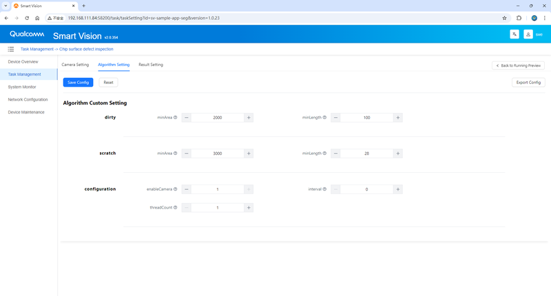

Algorithm Settings
- This interface displays threshold parameters related to the corresponding AI application. Different applications will have different threshold parameters, which can be displayed dynamically.
- Click Save Configuration to store the modified parameters.
- Click Reset to revert to the last saved parameters.
- Click Export Configuration to Local to download the current parameter configuration as a JSON file.
- Click Back to Runtime Preview to return to the Runtime Preview interface.

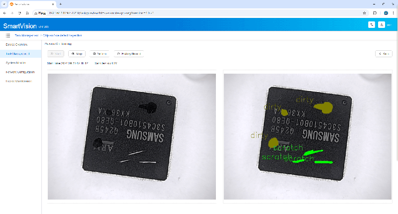

Take [Application Example (Segmentation)] as an example to run and preview the inference effect
Preview running effect
- Click the [ Start/Stop Application ] button in the list to run the application example.
- Click the [Run Preview] button to view the running effect.
Algorithm Settings
- Dirt: Dirt defects.
- Minimum area: Minimum area for dirt detection
- Minimum length: Minimum length for dirt detection
- Scratch: A scratch defect.
- Minimum area: minimum area for scratch detection
- Minimum length: minimum length for scratch detection
- Configuration:
- Camera/still image: whether to turn on the camera; 0-turn off the camera, 1-turn on the camera
- Image processing interval (seconds): Image processing interval; unit (seconds)
- Number of threads: The number of threads used by the application to actually process images, default 1

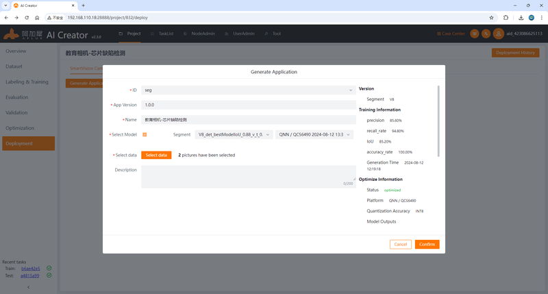

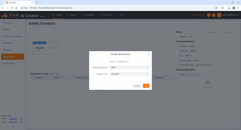

Step 4: Generate and deploy the application with one click from AI Creator
AI application generation

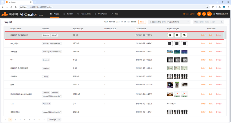

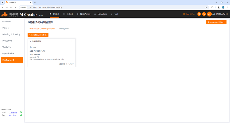

- Open the browser and log in to AI Creator. Click [Project Center] to enter the project list. Find the [Chip Segmentation] project that has been trained ( please refer to the AICreator user manual for how to train the AICreator model ), and click [Enter Project] to view the model details. As shown below:
Note: Since the model is trained on the x86 platform, if you want to run it on a smart camera or edge, you need to optimize the model. AICreator has built-in AIMO model optimization function and supports one-click optimization and advanced optimization. For the chip model of the device running the model, a series of parameters are preset for one-click optimization. The user only needs to select the chip model of the device running the model. The smart camera chip model used in our experiments is QCS6490, and it is recommended to convert the model to QNN format for running.

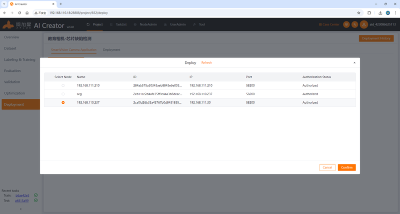

- Click the [ Model Optimization ] tab on the left, in the optimization release interface, click [ One-click Optimization ], select the QNN format and QCS6490 chip model to complete the model optimization.
- Click the [ Deployment] tab on the left, click [Generate Smart Camera Application], fill in the application information such as application ID, application version, application name, select the image data and click OK to generate the AI application.
Deploy AI applications to cameras

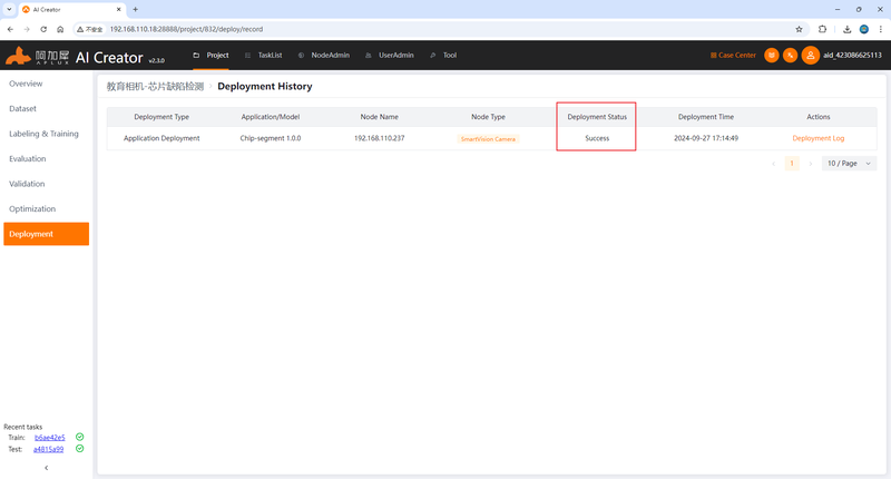

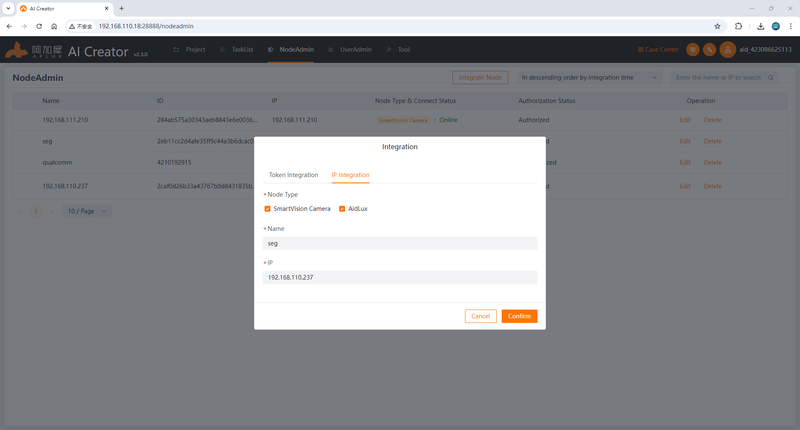

- On the node management page, click the [ Integrate Node ] button and enter the node name and the IP address of the smart camera in the pop-up form (for how to check the smart camera IP, please refer to "Step 2: Configure Device Information"). After completing the input, click OK.
- After the smart camera is successfully integrated, return to the application generation interface of the project, select the smart camera application generated in the previous section and click [ Deploy], then select the integrated smart camera node and click [ Start Deployment]
- After clicking, it will jump to the [ Deployment Record Interface]. When the [ Deployment Status] is successful , it means that the application has been deployed.
- Return to the smart camera interface to view the application list. A new piece of data has been added, which means the deployment is successful. Run it to see the inference effect.

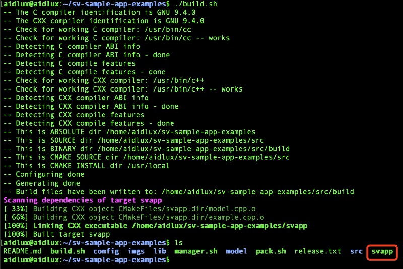

Once development is complete, you can package the specific project using the appc package command.
Command format: appc package -p <project path>Run the following commands on the Camera:
# Generate C++ sample code in the local directory
aidlux@aidlux:~$ appc init -t "cpp" -n demoApp
aidlux@aidlux:~$ cd demoApp# Generate Python sample code in the local directory
aidlux@aidlux:~$ appc init -t "py" -n demoApp
aidlux@aidlux:~$ cd demoAppII. Application Source Code Description

2. Compile the Source Code
# Enter the sample application directory
aidlux@aidlux:~$ cd ~/demoApp
# Run the build command
aidlux@aidlux:~/demoApp$ cd src/
aidlux@aidlux:~/demoApp/src$ mkdir build
aidlux@aidlux:~/demoApp/src$ cd build/
aidlux@aidlux:~/demoApp/src/build$ cmake ..
aidlux@aidlux:~/demoApp/src/build$ makeAfter the compilation is complete, an executable file named svapp will be generated in the root directory of the application.
3. Package and Deploy the Application
# Run the application packaging command
aidlux@aidlux:~$ appc package -p ~/demoAppAfter packaging is complete, a deployable application package will be generated in the application directory:
At this point, the entire application has been packaged. Next, proceed to the application deployment process. You can either deploy the application on this camera to preview the effect or deploy it on other camera devices.
Scenario 1: If you need to deploy the application on this camera:
(1) Run the sve application installation command
# Run the sve application installation command
aidlux@aidlux:~$ appc install ~/demoApp.zip💡Note
If the installation process prompts that the application already exists, you can add the "-f" parameter for forced overwrite installation:
appc install -f ~/demoApp.zip
(2) Restart the Smart Camera Application Framework
💡Note:
You need to restart the camera application framework service before the smart camera application list can reload and display the unpacked application.
# Enter the smart camera application framework directory
cd /opt/aidlux/cpf/aid-sve/
# Restart the camera application framework
sudo ./manager.sh restart(3) Open the camera management webpage, go to [Task Management], and check the deployed application:
If the sample application appears in the application list, it means the deployment was successful.
Scenario 2: If you need to deploy the application to another camera, first copy the application package to the PC
Run the following commands on the PC: (1) Copy the application package to the PC
# Copy the packaged application from the camera to the local PC
scp aidlux@[camera IP]:/home/aidlux/demoApp.zip ./(2) Open the management webpage of the other camera, go to [Task Management], click [Import Application Package], and select the application package from the PC.
After importing, if the sample application appears in the application list, it means the deployment was successful.
IIII. Preview the running effect
